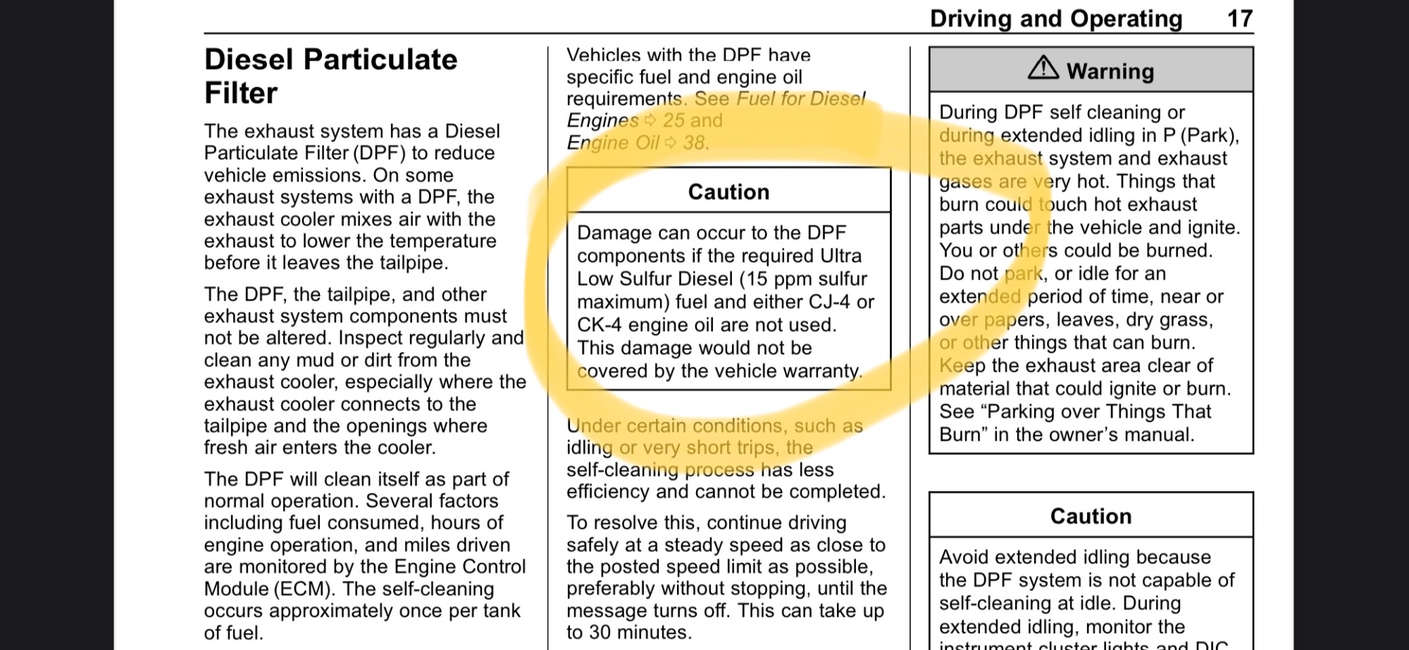

  8. I was interested in the Amsoil 0w-20 but it says do not use if Ck-4 is required. I am thinking the Cj-4/CK-4 bulletin might be a misprint in the supplement manual. I am also concerned about oil leaks that have been reported like the rear main seal. I’d hate to have a warranty issue because GM wants to blame non dexosD oil.
  9. It’s listed in the 3.0 Duramax supplement manual. This is the online version for the 2020 model year. I found my hard copy and this is not the same information listed under the caution for the DPF. This must have been an oversight for the 2020 model year.

  11. I have been using this oil exclusively since new. I only have 4200 miles now, but I have noticed my engine has more clatter than it had when new. I thought it could be a few things like fuel quality but then I figured the oil was thinning out. So I changed it at about 3000 miles with no real difference in sound. Started looking around for another brand in hopes to find a better oil, and as we all know there are almost no dexosD approved oils on the the market. So I figured I’d go by the API and SAE requirements and noticed something interesting. The AC Delco 0w-20 dexosD has no rating on the bottle or anywhere that I can find. This top secret oil has very limited information available online as well. I then checked the 3.0 liter duramax owners manual supplement and noticed another strange detail. The manual says to only use CJ-4 or CK-4 rated engine oil or “damage to the DPF will occur”. I have yet to find a 0w-20 that carries this API rating and now I’m thinking that the AC Delco dexosD 0w-20 does not have this rating either. Does anyone know what the hell is going on with the required oil for this 3.0 LM2?
