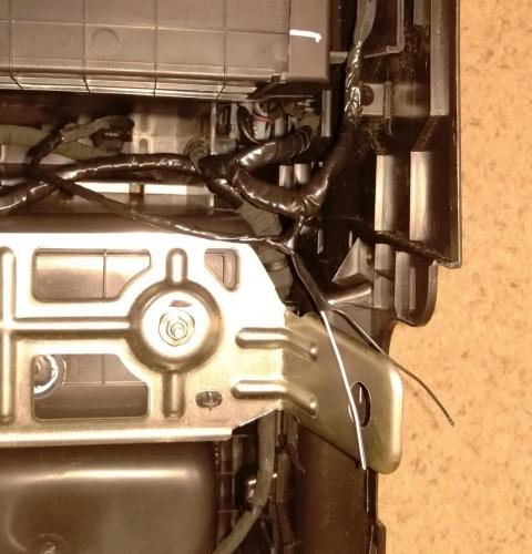

  3. As far as connecting wires for console light and switch, I read on a post that someone connected (spliced) the wires to the cigarette lighter in the front of the console. I would need to run wire to the front so obviously i would need to get donor wire from the console harness, but does it matter what size wire. Should it be the same size or would it need a thicker size wire (gauge wise). I should have left the white/black wire intact as it would have reached the front and the black one was spliced into 2 other wires with a larger one going to the front. Thanks

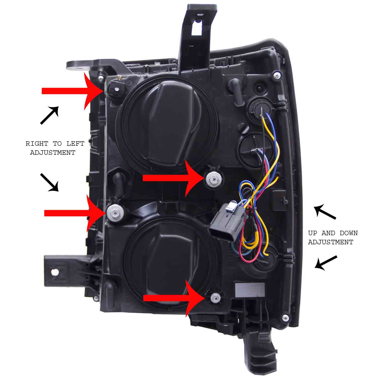

  6. I have the same headlights. Did you guys get this resolved? The adjustments screws are in the back and they are in a bad spot. They sit right in front of the radiator support frame. So like someone mentioned, you have to take the headlights off which means you have to take the radiator top panel, plastic between bumper and grille, and the grille off to make the adjustments. I was just thinking of drilling holes through the radiator support frame to be able to adjust the headlights without all that hassle.

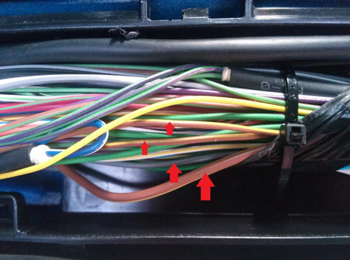

  14. Thanks ajmac, The instructions stated solid gray, but with your info I was finally able to get the lock working! Seems like the fat grey with green stripe works on the Silverado as well.
  15. Great post Moto. I wish I would have searched the forum before attempting the install. I had tapped into the 2 wires I thought were the correct ones but turns out I guess it wasn't. I tried again yesterday with another tan/yellow but still did not work. The photo below shows 1 large tan/yellow wire and 2 smaller tan/yellow wires. From what I could tell there is only 1 solid gray wire. Any guidance would be appreciated. Also, do I need both wires to be connected in order to test if it functions. I was only working with the tan/yellow wire and checking it against the green and blue wires from the lock. Thanks
