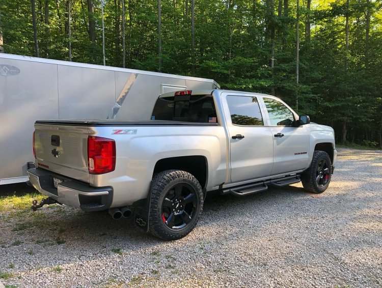

I’ve referenced this thread a lot over the years for multiple trucks so thought I’d come back and give something back when I had the chance: I had Bilstein 5100s at highest setting and ReadyLift rear +1”s installed 2 years ago by GM dealer. Angles seem fine. There was a point early on where I thought I was feeling some new slight vibrations, but I tend to be overly paranoid about stuff and all has been totally good for about 20,000. Finally pulled the trigger this weekend on Duratrac 275/60R20s. They fill up the wheel wells a LITTLE more than I anticipated, but fortunately I like the bigger tire look over the lifted/high clearance look anyway. No signs at all of rubbing after first 100mi. I also have gatorbacks as you can see from the pic, and those eat up some space as well. We’ll see if it’s completely rub-free after a round of towing or two-tracking. If so, zip-ties should take care of it.
Interested to hear how your tires fit, as I just did the same level setup. Which rear blocks did you go with? With a lot of highway commuter miles, I haven't been in a hurry to size up, but will probably end up just going 275/60 or 285/55 when I do. I see you've got the Airaid MIT in your signature....any feedback on that? Worth it?
