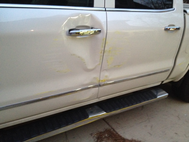

  1. side swiped a pole after sliding on road... Sucks.... after repairs looks brand new.

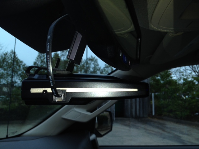

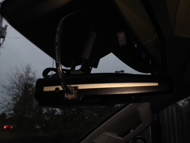

  2. I tapped into the wire that remains left after removing the mirror and connections.
  3. Yes I have the lane departure. When you remove the plastic you wont have to touch this part. Remove the mirror to allow easy installation of the inviscord to tap into the mirror connection wires. This is really the cleanest way to install the radar detector as opposed to using the A pillar or overhead console. If you have the powered mirror and Lane Departure this is especially true. You can get power from the wires going to the mirror.

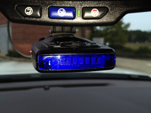

  4. Sorry for not adding new pictures. Wrecked the truck and has been shop for repairs. Here are the updated pictures of the install.
  5. Hey guys, new to GM-Trucks forum. Long time tundra guy who made the switch and freakin love the truck! Wanted to give help to anyone looking to do this mod. The difficult part was finding instructions on how to remove the mirror and plastic covering for the Lane departure warning system. (attachment). Once you remove the plastic pieces covering the mirror you can remove the mirror with the allen wrench to unplug the connection. The plug taps for the onstar mirror are 1) 12V hot is Pin #2 Violet with green stripe wire 2) Ground is Pin # 5 solid black wire. I used the blend mount in my prior vehicles so decided to stick with this. It cost more than the others (performance package and rogue mounts). You can use the mirror tap or cheaper invisicord. I chose to go with the latter (invisicord #N01PL micro version 16 inch with fuse). 12 inch length could work but make sure you use the micro connector taps. Not a difficult to do. Be careful when removing plastic piece number 2 on the diagram. The side tabs can stretch and break easily. other than that a piece of cake...
