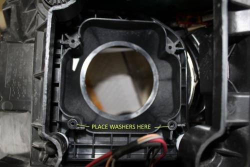

  3. OK folks. I finished my FX-R install this afternoon. I did have one major problem yesterday I didn't mention. As it turns out, my housing's stock projector mounting bosses were a tad too short. When I tightened the screws and admired my handiwork, I heard a pop after a few minutes. Looking at the lens, I saw immediately what happened: the lens cracked and a chunk came out. It looks like the cause was that the lens housing was being smushed up hard against the lens port in the housing. I immediately called TRS and inquired if they had replacement lenses... Thankfully they did, and I had one overnighted! Shipping was more than twice the price of the lens replacement, but I got it today and completed the job. What I ended up doing was gluing washers onto the stock bosses as spacers to get the pressure off the FX-R projector. My driver's side needed one washer per boss. Oddly enough, the passenger side needed two per boss. I just used CA glue to keep them in place until the projector was installed. They fit perfectly now! Here's what I did: Cheers, John

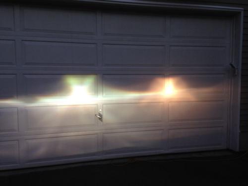

  4. I got half of my FX-R conversion done tonight... Vehicle is a 2014 Sierra 1500. Here are some pics of stock vs FX-R with 3Five ballasts and bulbs: Front on view, stock vs FX-R (This isn't exactly a good photo. The iPhone doesn't do well with bright lights. The drivers side isn't that blinding or yellow in real life) Low beams, stock vs FX-R (Driveway is not level so they look like they're slanted) High Beams, stock vs FX-R (same reason for slant) Cheers, John
