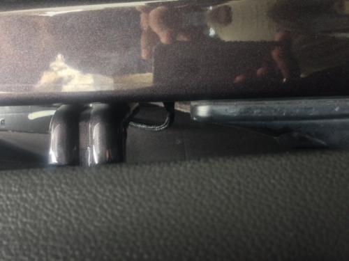

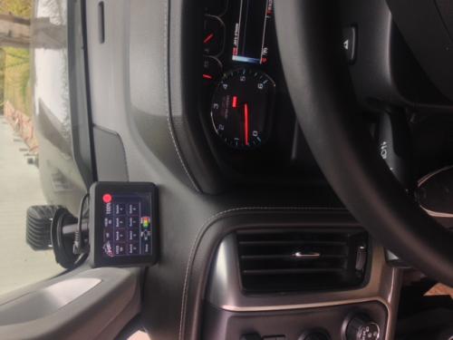

  3. Got impatient and went ahead with install. Used the door grommet which worked out perfect since I needed the cable to come out by the front drivers assist handle/pilar. Simply fished it through, removed the side cover on the dash and fed the wire up to the pilar. Install was very easy and came out really clean. Used some silicone to add some waterproof protection to the grommet I went through. Mounted the spod onto a bracket I made that mounts on the spare battery tray. Seems to be the best option in these trucks. The spod was a bit pricey but is easy to install and has a bunch of cool features. I have the option to dim or strobe my lights. I also have the ability to add 7 more lights by simply mounting them and plugging them into the spod, no need to fish more wires into the cab or add switches. I also didn't have to drill and holes for the switches which is a plus. Simply replace the rubber door grommet and everything would be as if I never modded the truck. Definitely a plus in my mind. Will post some pictures if people want them.
  4. Just installed the T-Rex hood brackets and a set of Rigid D2 driving lights. Install was easy and fast and the brackets hold the lights securely. Definitely recommend them to anyone wanting to do the same. Question, I have a Spod controller with their new touch screen switch panel. In looking at my truck it seems its not going to be easy fishing a line through the main wire harness grommet in the engine bay. From the inside of the truck there is so much stuff in front of it I can't even get my hand behind to feel it. Any suggestions or help? It should also be noted that I have to fish a headphone style jack with a 90* bend at the end. I also see some people have suggested going in through the rubber grommet in the door jamb. Seems like an easier install and appears it can be done cleanly and without and pinching of the wire. Any reason not to do this?
