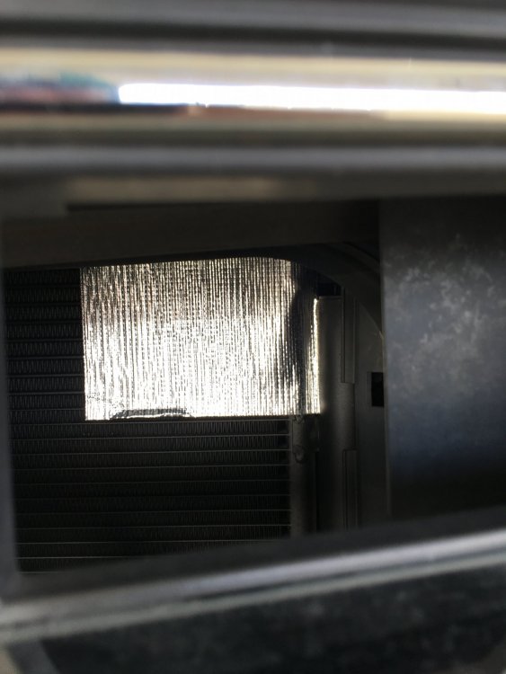

  8. I am not familiar with the 2016 A/C issues - just know that when I pressed the dealer about this he mentioned there was Technical Service Bulletin (TSB PIT5331)MC-10145171-9999.pdf http://www.gmcproblems.com/ac-condenser-leaks/ It affected a lot of GM vehicles from Sierra to Escalade and Yukons/Suburbans... it is a crime! Not familiar with any aftermarket - they replacement the put in has the heat shield and when they did the A/C condenser - the did not do the hose that was part of the TSB in 2014...

  11. 2014 Sierra 1500 - 60K Reading this thread is depressing... Never stops. I had to bring my back for the 3rd time.... and am crossing my fingers that they fixed it...... First experience was at about 45K - started blowing hot air... so the did a service - recharge and put the dye in it...$(350) .. that lasted a day. I had one of the faulty condensers .. you could see the dye leaking out the weld.. They fixed that - out of warranty........ $1500 - charged me $700 and figured got off cheap.... $1000. 2 yr. warranty. Month goes by and we had a little heat wave...... turned on the A/C and blowing hot air again..... Took it back... they check it out again and said it was not the condenser but a hose ... had a pin hole....... Again... $1500 quoted and ending up charging me $675 for a hose, seal and freon.... The problem is the dealers know about this stuff...... it generates revenue for the Service Managers. To date - almost $1700..... waiting for the other shoe to drop........... Oh... it did...... At 63K and just hitting the 5 year mark.. the right rear axle started leaking.. said it was past warranty......would not cover it...... $300+ Funny thing is that I had them do a 60K service around 59K and they did not see it..... Are these trucks that bad....... like owning a boat..... The dealer says .... it is 5 years old.... it is the cost of ownership? Really??? Really thinking hard about throwing in the towel on this one..... I figured it would be the last vehicle I purchased ..... get 150K+ out of it...at least 10+ years before any major maintenance besides brakes and tires..... just got the tires.. at least they lasted me 60K. What is next? The computer? Frustrated in CA.
  12. Originally mine was blowing warm air at about 53K and took it in to get it serviced - that lasted less than an day and started me down the "rabbit-hole"... I had mine replaced in March on my 2014 Sierra - it looks totally different from the original one - has some sort of heat shield. Are there any plans for GM to reimburse anyone for the repairs? I got out of there for $700.00 - they stated that the higher cost was due to having to remove part of the front end? They submitted through some GM Customer Service program that "assists" with these type off issues....... It was still very painful to the pocket book!
