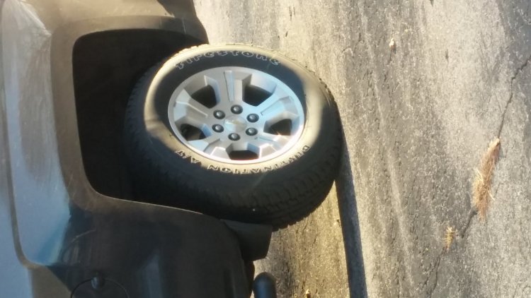

  12. So got new tires and back to the ol' balance and road force thing. Destination AT from the Goodforoneyears. Well the light hit just right and saw this. Is this just cord overlap? I've never hit anything, and doesn't look like normal pinch bulge.... Suggestions,? Thanks.
  13. When they bust out the PICO, it's their STFU button. Always in spec. Good luck.
