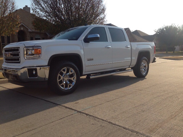

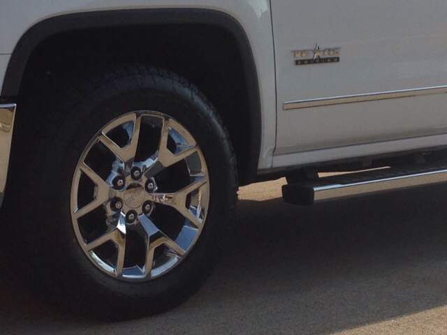

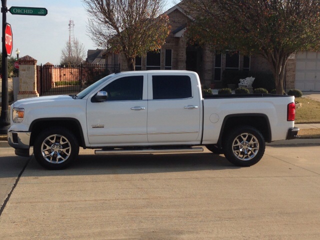

  3. 2014 slt 6.2 Original stock tires were 275 -55 Goodyear eagle Replaced with 275 60 grappler G2. Ride is slightly stiffer but drasticLly improved over pot holes and larger bumps. Tires are an inch higher than stock Next adding the bludgeon 5100's if the fronts would ever come out! Attached Thumbnails
