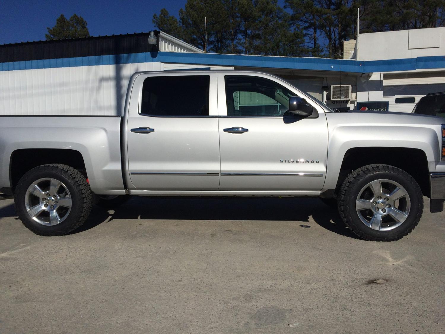

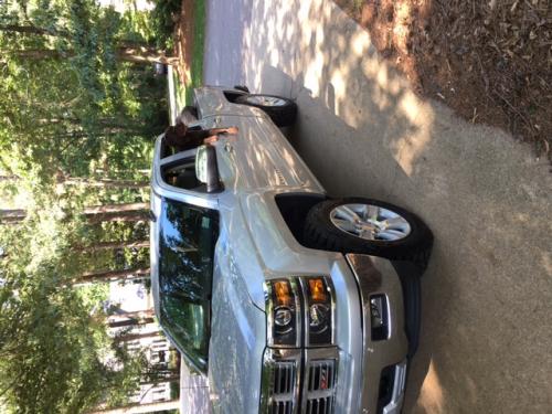

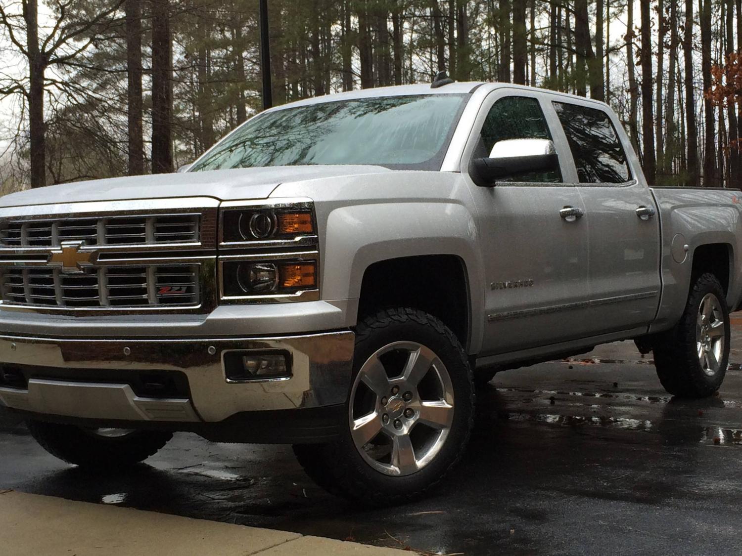

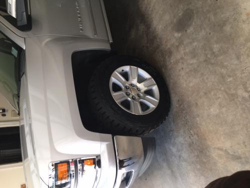

  2. Hey guys, thought Id throw this up here just for informational purposes. Before getting these tires, I researched and researched and never was able to find multiple examples of a definitive answer as far as how big I could go with just a level. So here ya go, hope this helps: 2015 LTZ Silverado 6.2 Stock GMC polished wheels (caps swapped with bow ties) 275/65r20 TOYO OPEN COUNTRY R/T No rubbing at all in any direction under any circumstance. I am moving up from 275/60r20 bgf ko2s and I gotta tell ya, these tires ride significantly better with very minimal road noise and they look great. MPGs have taken a hit though, but I didnt get a truck with a corvette engine to get good MPGs. Hope this helps anyone out there searching to see how big they can go under a leveled truck

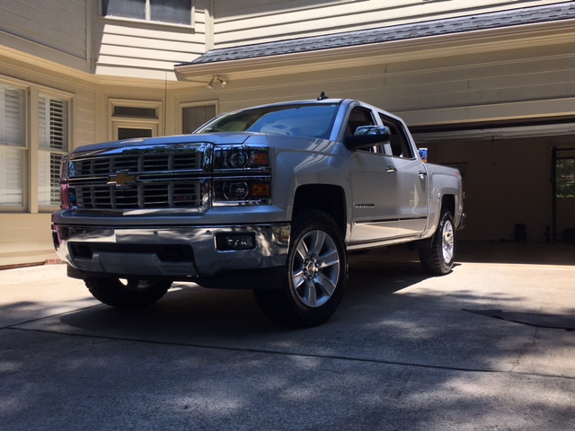

  8. Here's mine, picked her up last week 6.2L Z71. 2" Tough country level and 275/60r20's. Also, had the dealer get rid of the chrome 20's that came from the factory and swap in 20" brushed aluminum.
