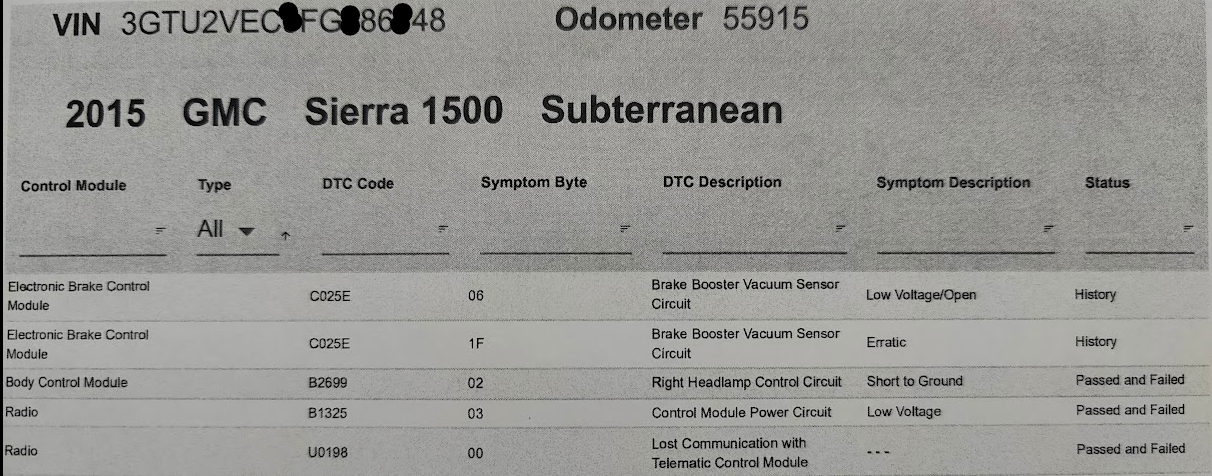

I am experiencing this exact scenario. Do you happen to have any examples I can present to the dealership. They are replacing the Vacuum Pump for the second time (under the recall warranty, again) yet, this time my Booster has oil in it and they are charging me to replace the Brake booster and the Master Cylinder. It obvious this is a cause and effect thing. Brake Drag --- Booster and Master Cylinder have an internal failure.

Thank you for taking the time to aid in my troubles! I just got back from the dealership and I think you got your answer into the voting booth just in time to win the prize, lol. Sorry, fresh out of prizes after the cost of this roller coaster. Here is what they had to say: They are going to replace the MC and the Brake Booster. Also they are going to replace the Vacuum pump + Belt (for the 2nd time) and get it covered under the recall (again). Technician drove it and (thankfully)experienced the brake drag on the test drive. He opened the hood and disconnected the vacuum hose to the brake booster. While this obviously made braking a harder, the brake drag was gone and he was able to get the truck back to the dealership. I was told that they also found Hydro fluid in the booster. So that's all I've been given... They didn't really tell me what the exact failure point was other than its somewhere between the Vacuum pump and the MC. Thus, replace it all and it should be fixed. Should I be asking more questions to the dealership about this problem, or it is what is? I'll give another report back for the purpose of this thread after I get it home. Thank you to everyone here that helped. oh If anyone is curious, $1,333

I'm hoping someone can help me with this mystery. I cannot figure out what is causing my brakes to engage or rather not "disengage" after about 10-15 minutes of driving around. When the issue occurs, It starts off slowly with a slight sensation that the truck is suddenly pulling a heavy trailer, but then steadily becomes worse the further I go, eventually having to floor the gas to pull over safely off to the side. In the short term, If I pull over and pump the brake pedal a few times and start driving again it seems to fix the problem but only for a short while before it happens again. I have an OBD2 reader but it doesn't grant diagnostic data for brakes. I do have a live data read out of everything while the occurrence happens and would be glad to provide it if someone is able to use that info to narrow down a conclusion. When the issue happens, I can just let off the gas and the truck will come to a stop without needing to apply the brake. The feeling as if you're going through thick mud. I changed my brake pads about 3000 miles ago, so I don't see a correlation to my DIY brake job being the cause. The truck has 56K miles. Things that I've done so far: Replaced the Brake sensor control switch (code was thrown that mentioned Stabilitrak (it led me down a rabbit hole) (pain in the F'ng ass) - Still have issue. Took the calipers off and greased the pins. thought they might be getting stuck. - Issue is still present. Update: 01/20/2024 Replaced both front wheel hub assembly Added new brakes, Rotors, calipers Issue is still present. My next step would be to replace both the front calipers. <-- NOPE. I feel like I'm guessing at this point and the cause could be a Master Cylinder, Brake booster, Solenoid, bad brake fluid or lines. And to add, I have conspiracy monkeys in my head telling me it's all still related to the faulty GM vacuum pump issue. All this to say, if someone has dealt with a similar issue in the past and figured out the cause I would be grateful to hear from you. Past service history: Service Performed: 28K miles: Electronic Brake Control Module Reprogramming with SPS AIR CONDITIONING CONDENSER REPLACEMENT Vacuum Pump Replacement Power Steering Control Module Reprogramming with SPS Service Performed: 11K miles: SDM PROGRAM (@11,000 miles) Transfer Case Shift Control Module Reprogramming with SPS
