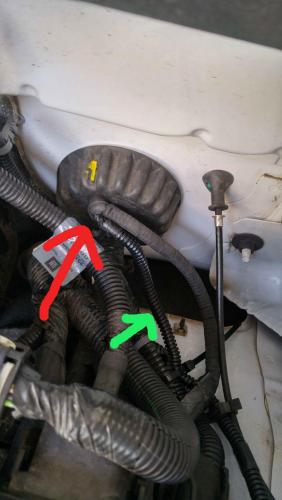

  14. Now you zip tie the harness to the main body harness, making sure there is a low spot to act as a drip loop and then cut a slit in the small upper protrusion on the grommet to prepare to run the wire through. the red arrow is where you cut the slit and the green arrow points to the remote start harness the zip tie is just below the green arrow. Normally there would be nothing else going in in the same place but I have also installed tow mirrors on my truck and those also go in through the same part of the grommet

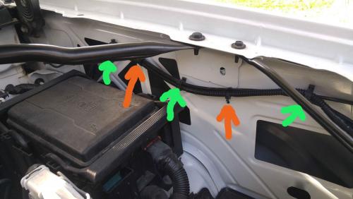

  15. next the harness runs along still following the hood release cable. The factory instructions say to only put the harness through 2 of the 3 clips on the side of the engine bay but I put it through all three, I then zip-tied between the clips Green arrows are clips Red are where I zip tied
