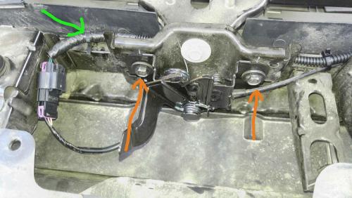

  17. After you remove the front sigh shield you must replace the hood latch, It is held on with 2 bolts. The red arrows point at the bolts you need to remove, the green arrow points to where the barbed zip tie fitting goes to secure the harness
