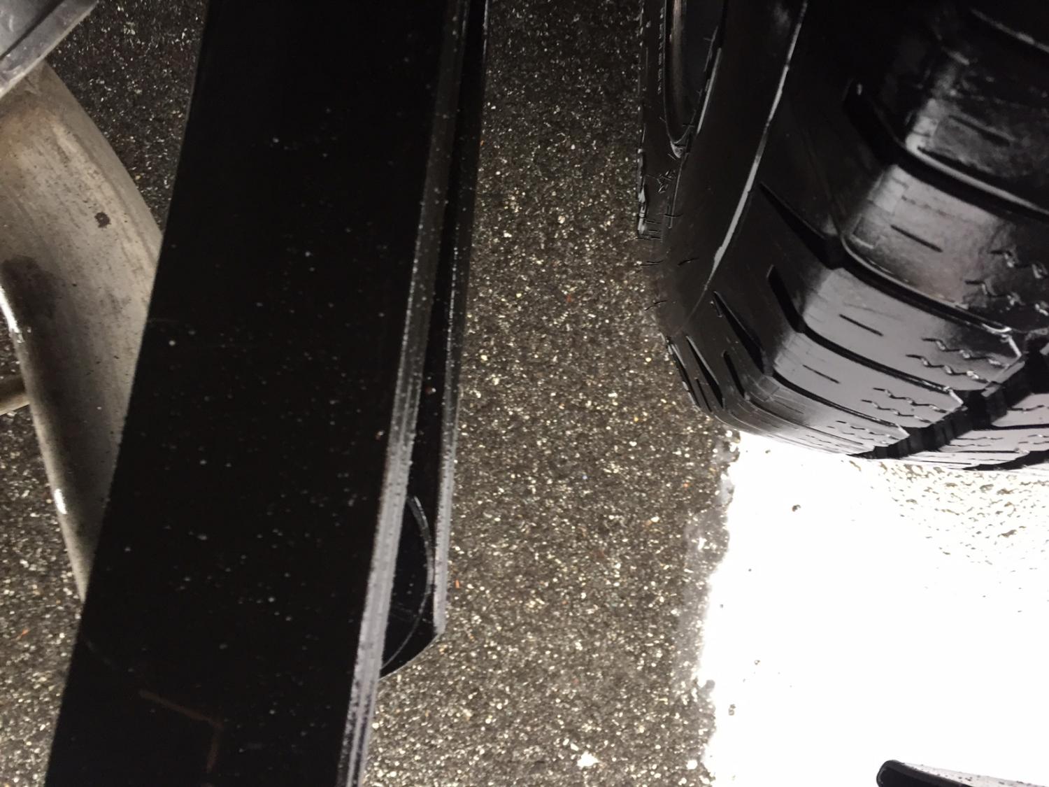

  9. So took my truck for my first vibration visit. They told me front two tires were out of balance picked up my truck and guess what still there.. Laughable. So after reading this and other vibration topic I literally sent these threads to the service manager to review. The game plan is driveshaft balance, possible engine mount shim 3mm, then leaf springs. Should be going in Monday or Tuesday. But also after reading this thread I inspected my leaf springs and the passenger side the bottom leaf literally is not stacking inline on top of the others see pic. I also had experienced during a turn and hitting a bump the truck almost feel like it jumped and the rear end slid
