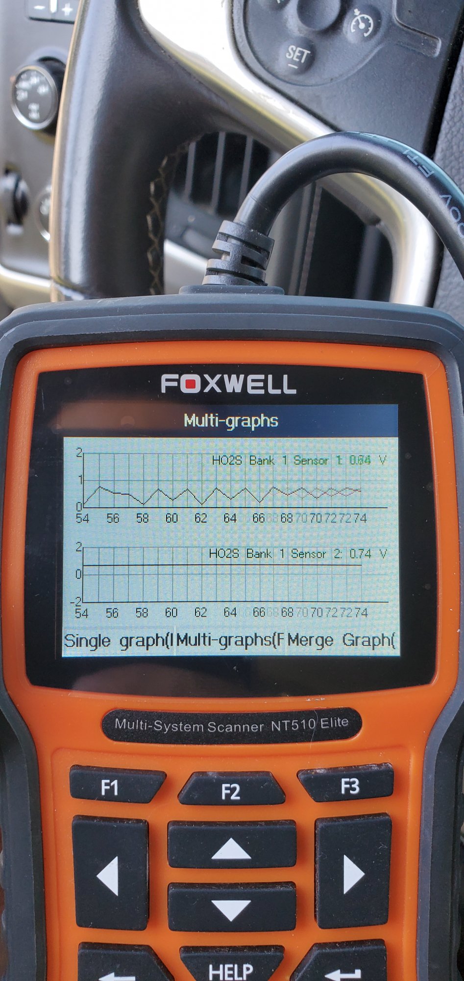

  3. Yes I have done all of the above. I need to run to the dump, so I will do that when and when I get home I'll take some pics of the live data and post them. my scan tool is not as fancy as the one above.

  8. Hey guys, I'm not sure what to do other than light this thing on fire. 2015 GMC Sierra SLE 5.3 Gas, Replaced Cats / Y pipe by gm at 79000 miles under warranty that was after they had my truck for a week going through all of GM's guideline tests to get it covered. At 100K miles Check engine light came back on. Same codes P0420 and P0430. - Put new plugs and wires in and found that both sparkplugs on the rear cylinders had some of the ceramic missing. Replaced them with NGK 5019 - Replaced plug wires with MSD 32819 - Replaced front and rear 02 sensors with Denso 4940 and 4974 Cleared codes drove it around taking it easy on it and both P0420 and 430 came back within 10 miles So I bit the bullet and ordered replacements y pipe and cats from magnaflow: Magnaflow 52642 | GMC/Chevrolet | Sierra 1500/Silverado 1500/Suburban/Tahoe/Yukon XL | 4.3L, 5.3L | Direct-Fit OEM Grade Catalytic Converter Federal (Exc.CA) While I was doing that my battery starting acting up so swapped that out with a AGM. So being that everything was cleared at the time drove it for about 3 days no issues...guess what codes are back. The odd thing now is that before it would take 5-10 min and the code would come back now it takes about a day or so. But same thing... P0420 on bank 1 / P0430 on bank 2. I’ve checked for exhaust leaks and rechecked the bolts on the y pipe and made sure the O2 were tight. I’m at a loss here...no idea. My local GMC dealership auto parts department are morons ...previous dealings so I don't trust them. Any thoughts? Unfortunately I live in a state that needs the codes cleared (NY) Any help would be greatly appreciated. John
