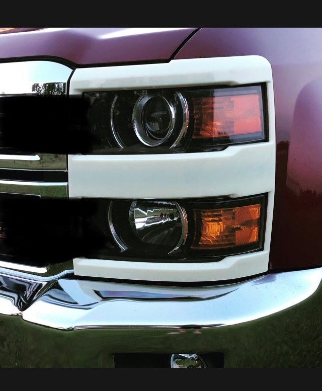

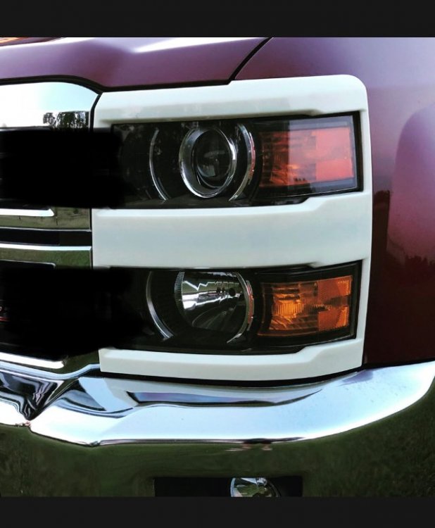

  1. Bought them separate off eBay. Really cheap. They are an overlay for the factory ones. So if you get them and paint them make sure you tape off your stock lights and paint or dip the factory outer bezels in black. That way no one will notice if some of the stock bezel show a little around the edges.

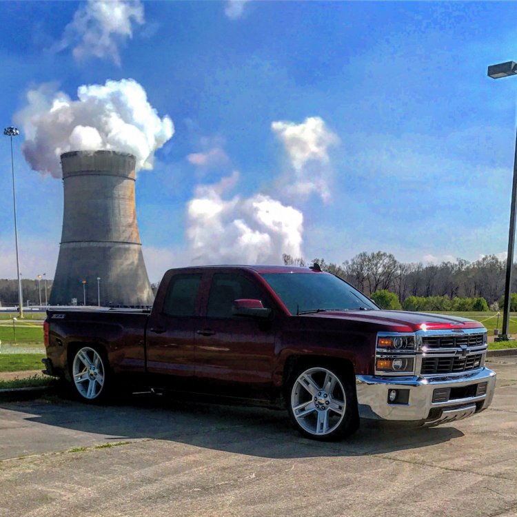

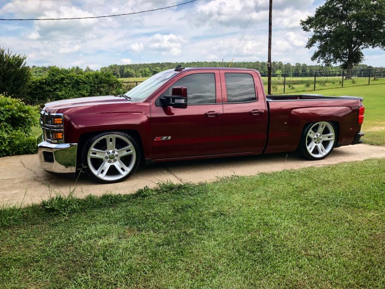

  11. 2015 Silverado Z71.. Dbl cab.. 4wd -6/11 “static drop” - DJM 4” drop control arms - DJM 2” drop spindles - Bell tech 0-3” drop struts (set @ 0) - DJM 7” flip kit - DJM 2” drop shackles - Reklez 2” drop blocks - Twisted Metal Workz shock relocation kit. - Fox 2.0 adventure series shocks - Extensive Metal Works 8” notch with crossbars. - AVS wheel tubs and tunnel cover - Shortened steel driveshaft - Cresspo Tailgate Spoiler - 2015 Silverado 2500 front bumper - Full LED highs, lows, parks, fogs - 2500 tow mirrors - Range AFM delete - Borla Attck exhaust - 24” Chevy Platinum Texas edition wheels. - 275/30/24 fronts - 296/30/24 rears
