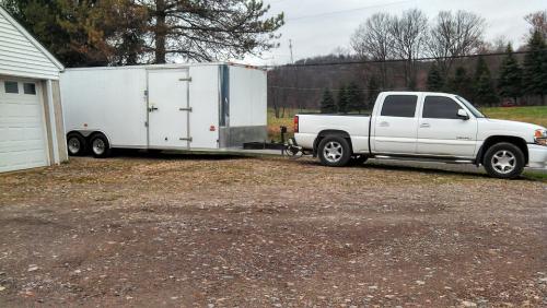

  5. Removing the upstream sensors did not do the trick. Man did it sound like a demo car though.
