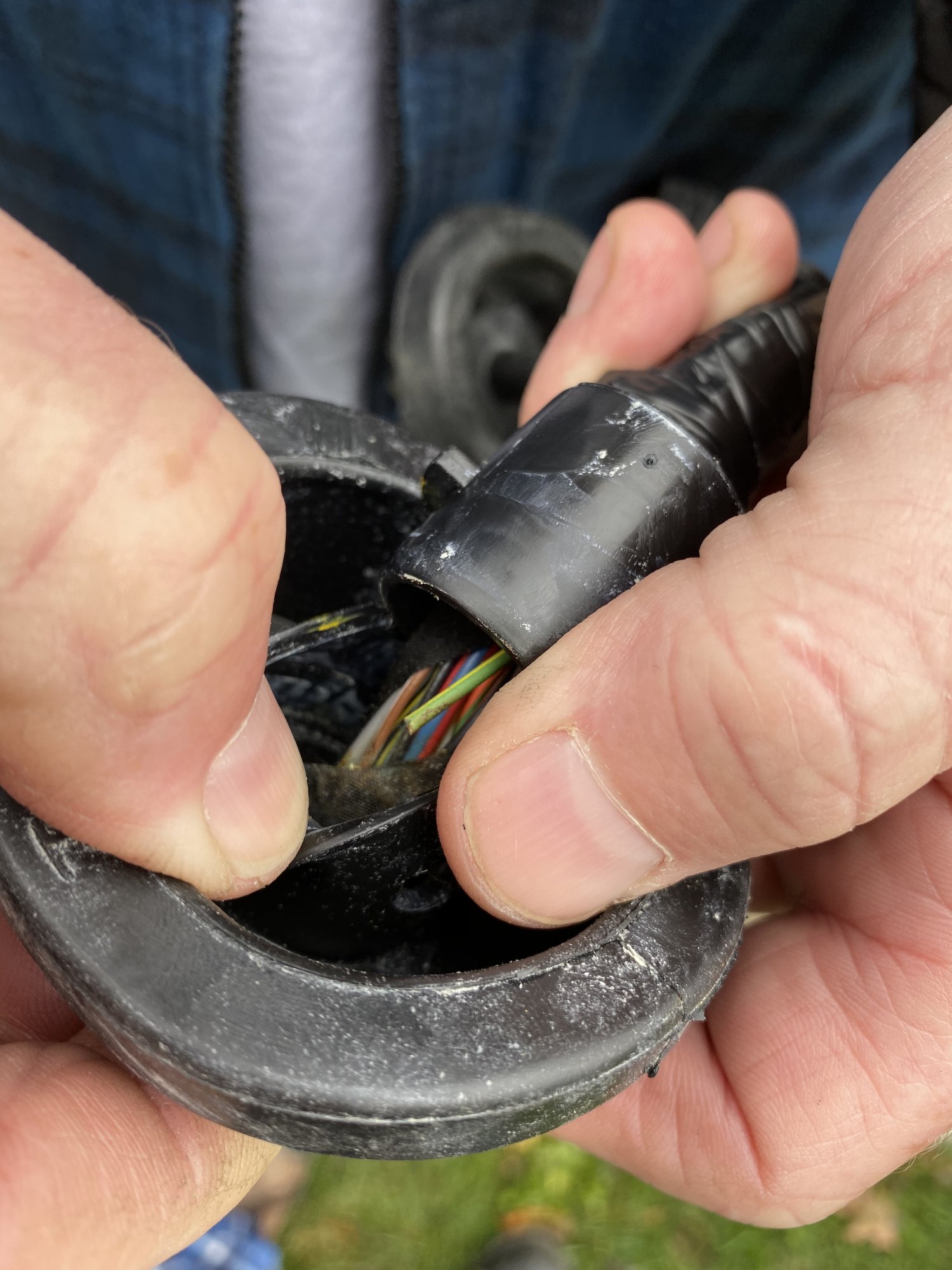

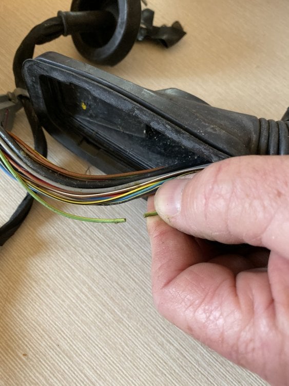

  8. Following up... I soldered in about an inch of wire on the break. I also pulled it so there was a bit of slack on both ends. Originally, I was worried that adding wire would somehow mess with the resistance of the wire enough to trigger computer issues or whatever TF else that could go wrong. I have had zero issues and full operation on my door panel. Todd, I would not have found my break without pulling the harness out. My break was actually behind the fitting that goes into the door. My second pic is a bit deceiving. I pulled the door jam boot back past where the the fitting met the door so I could have more access. I would not recommend your method as you will most likely cause more tension and another break soon thereafter. I would add a bit of wire for sure.
  9. Hey Phil, Thanks for the response. No work has ever been done on the door, until now... I found the issue... Pics attached... Heres a question for you, If I add a little bit of wire to the green and yellow, will it mess with the operation. Obviously adding wiring will change the resistance of that wire. Ideally I would love to add even just a half an inch to lessen the tension on that wire and prevent stretch. Let me know what you think.
  10. Hey all, after fishing the wiring harness out of the door I have found the issue. Underneath the the rubber boot in the door jam, right where the fitting goes into the door, my green/yellow wire is cut clean. It almost looks like somebody cut it with a pair of scissors. Everyone having these issue is effed up. I’m going to add a little bit of wire to give it some length so it’s not tight tight, and then solder and heat shrink. This will resolve my issue as there is no corrosion. I will post a picture when I get computer access. Sent from my iPhone using Tapatalk
  11. So I have gotten this far. My connections look EXCEPTIONALLY clean. I can also find no evidence that the green/yellow is out of the pigtail. Upon reconnecting the door panel to see if I could get up and running again, I am still left with no power and a door ajar. What would be your next step of troubleshooting? Thanks, Matt
  12. Hey all, please forgive of a repeat post, I am computer less right now and craptalk app is my only means of searching (absolutely horrible interface) and posting. I have a 2017 Sierra and ran into an issue with my driverside door. I currently have no control over my windows and the door alarm constantly says that the door is open. The light for child door locks comes on when pushed but no light on the window locks. All windows can be controlled on their individual door switches. I’m hoping this is just a dud fuse, but can’t seem to find which one it is, even after looking in the manual and online. Any help would be appreciated, and if possible would love not to get wrecked at a dealership Thanks Sent from my iPhone using Tapatalk
