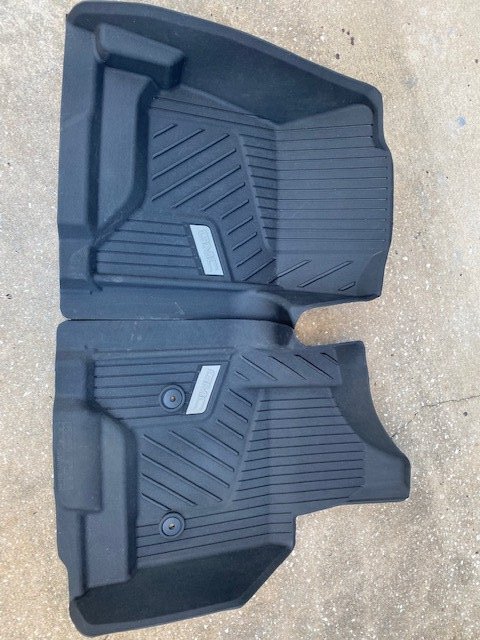

  7. First-Row Premium All-Weather Floor Liners in Jet Black with GMC Logo (for Models with Center Console) Part No. : 84185474 Precision engineered to meet the exact fit and appearance standards of your interior Deep-patterned, molded grooves help channel debris, snow, and water away from the vehicle’s carpeting, as well as your feet and clothing Custom-designed, raised sides provide maximum carpet coverage and a barrier to help contain mud, snow, and other debris for easy cleaning Three-dimensional design specifically developed for your vehicle Features high-friction backing for outstanding traction Can cover previous wear of interior floors and helps protect against future wear from everyday use Made from premium materials GMC logo adds a customized feel to your vehicle's interior For models with Center Console Custom cargo mats and cargo liners are also offered for a unified look and protection throughout your entire vehicle $75.00 Plus Shipping.

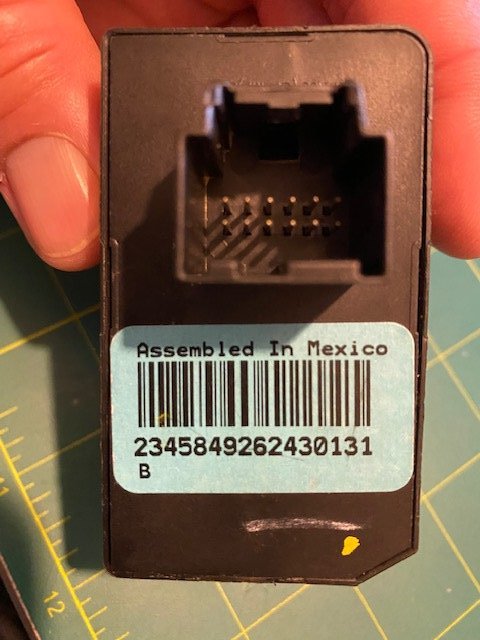

  8. GM Headlight Switch USED OEM HEADLIGHT SWITCH FOR GM 2014-2019 SILVERADO/SIERRA, SWITCH INCLUDES OPTIONS FOR FOG AND AUX DRIVING LIGHTS. THIS IS THE SWITCH EVERYONE IS UTILIZING TO UPGRADE FROM THE OEM ORIGINAL FACTORY INSTALLED SWITCH WHEN ADDING A LIGHT BAR OR ADDITIONAL LED'S. THE BACKLIGHT COLOR OF THE SWITCH IS BLUE AND MATHCES THE REST OF THE LIGHTS IN THE CLUSTER AND DASH CONTROLS. SWITCH IS USED AND FULLY OPERATIONAL/NO BOX. $20.00 plus Shipping .

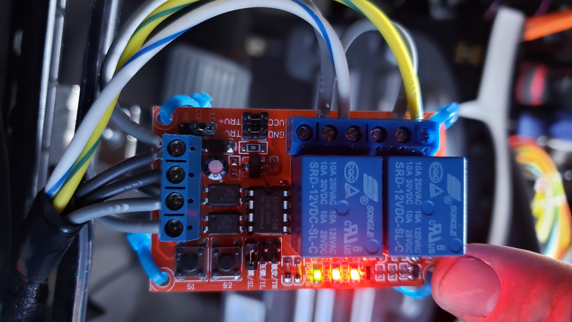

    No instructions came with the relay.
    1. Show previous comments  5 more
    2. Seapacer2
      Seapacer2
      RACERX775
      My jumpers are as follows:
       - LO / COM
       - SL / SL
       - TRV+ / VCC
       - TRV - / GND
      Hope this helps.
    3. RACERX7775
      RACERX7775
      Hmm. When i had it on LO-COM it didnt work. Ill have to recheck wiring tomorrow. Wonder if the relay assembly is bad. Or my switch isnt putting the signal OUT to the relay. This pic is with the jumpers correct. Just doesnt work with the headlight switch to activate it.
    4. RACERX7775
      RACERX7775
      Ok!!!! GOT IT WORKING!!!! I traced it down to the broken gray wire from the headlight switch down to where the BCM is. I left the harness that I got from Phil in place and just hooked it up to the relay board. I checked for power. Was getting power at the board CH1. at the connector where i spliced it in, but no power at the headlight switch.  I cut the wire at the headlight switch, ran a new gray wire down to the relay board AND NOW IT WORKS!!!!! I only have to do a simple tap on the headlight switch and it turns on and off.  The switch lights up amber but no icon on the dash.
      THANK YOU VERY MUCH FOR YOUR HELP. NOW THAT IVE DONE IT, ITS PRETTY EASY TO DO.
  13. Yes, you hold the ORL button down for a few seconds, it turns on. Push button again to turn off. i have attached a photo of the 4 channel relay, disregard the wiring color, I utilized what ever I had in my tool box to test the operability of the system.
  14. I got my latching relay from Amazon, https://www.amazon.com/gp/product/B07BLRV92L/ref=oh_aui_detailpage_o03_s00?ie=UTF8&psc=1 NOYITO 4-Channel Relay Module DC 5V 12V 24V Self-locking Triggering Interlocking High Low Level Trigger for PLC Industrial Control Arduino (12V) Pay close attention to your jumpers, I had to move them to get it to work, this latching relay works great.
  15. I'm still having issues after installing my new switch and wiring harness, my ORL light in the cluster does not come on or no voltage is being outputted from the switch. The other day I acquired a latching relay, with it connected to the BCM, the switch does not operate and stay on.. I disconnected the BCM terminals from the wiring harness, the switch works great. No ORL at all on the dash, but the ORL indicator in the switch lights up. I have a 2018 GMC Sierra 2500HD SLT, has anyone else had this issue?
