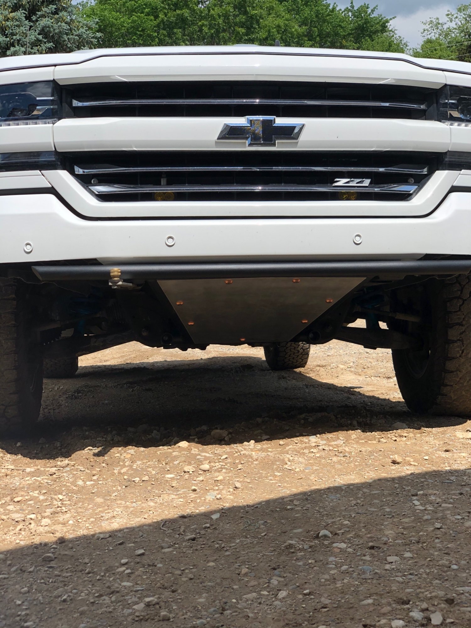

  19. Plugging away. Heads off. 1 bent pushrod, in addition to my broken one. Cylinder 4 and 5. Lifters weren't stuck. Everything else looks fine (Pistons, cylinders, valves, etc). Guessing AFM lifters got sticky at one point and freed up? Over rev? Who knows. Sent from my iPhone using Tapatalk Pro
  20. Started to tear it down Sent from my iPhone using Tapatalk Pro
  21. Just like the suspension, I got a hell of a deal on the parts. Sent from my iPhone using Tapatalk Pro
  22. Broke a pushrod Sent from my iPhone using Tapatalk Pro
  23. Got a bunch of parts in, still need to order long tubes, and find a valve spring compressor that isn’t 100 dollars plus lol. Anyone have a used one they no longer need before I machine one? Sent from my iPhone using Tapatalk Pro
