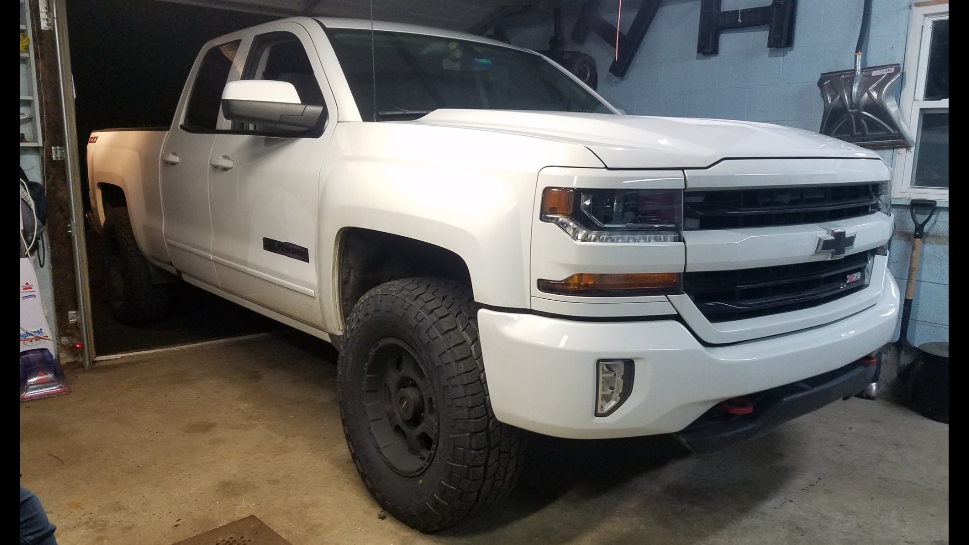

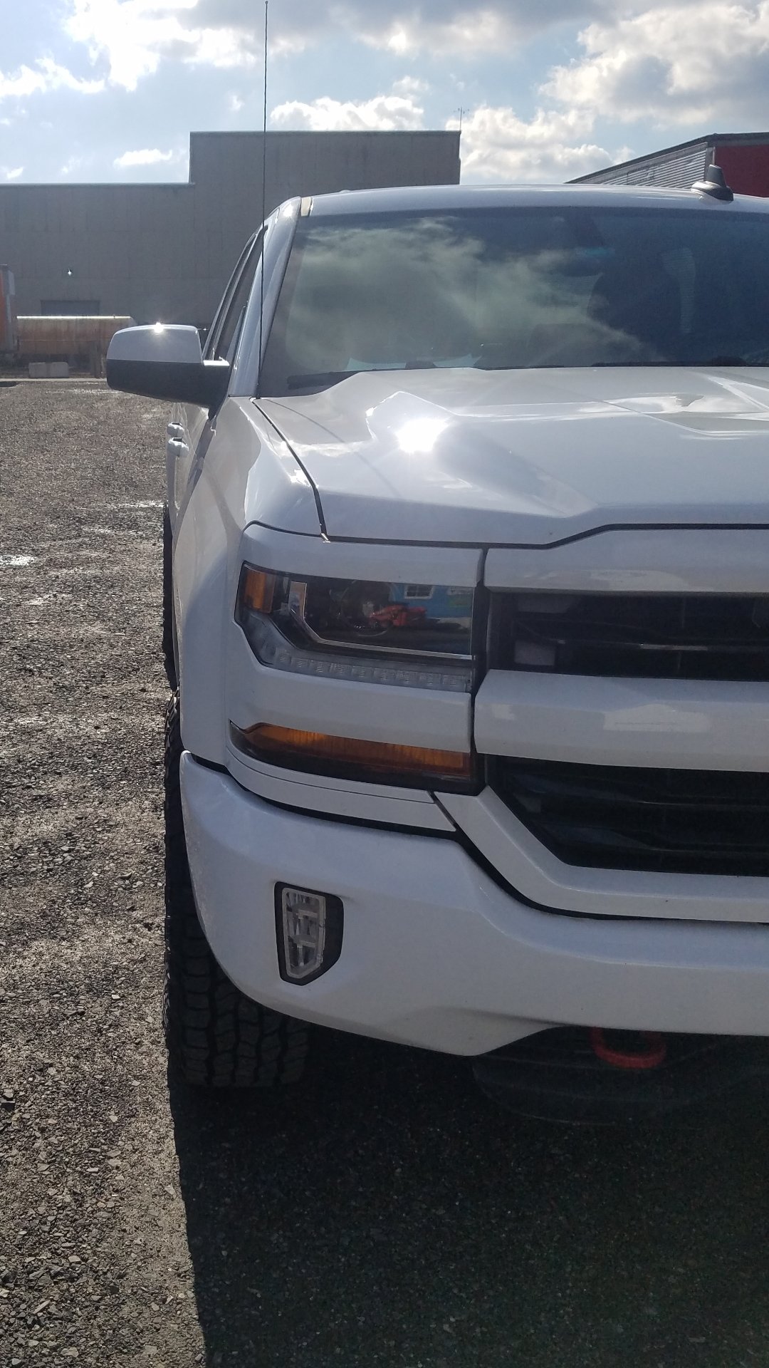

  1. I trimmed maybe an inch off the black fender insert on the front fender and plan on pulling back the fender liner a bit but the rub is minimal in reverse at full crank. Definitely worth it
  2. Bilstein 5100s with 285/75r17 at3 xlt. Pro comp 7089 wheels. I've had these wheels before and they were no where near this flat. They were more of a satin or matte but I dont mind.
  3. Just bought a 17' z71 1500. Planning on doing a bilstien 5100 swap on the highest setting. I know I can easily fit 285/70r17, but I'm wondering if anyone has put on 285/75r17. I'll be expecting some rub but I'm hoping it's just on the inner fender wall. Any advice or input? Also, my buddy has 295/70 17 that I'll just throw on to see how they fit. I heard with some offset they may hit the sway bar. Has anyone installed these?
