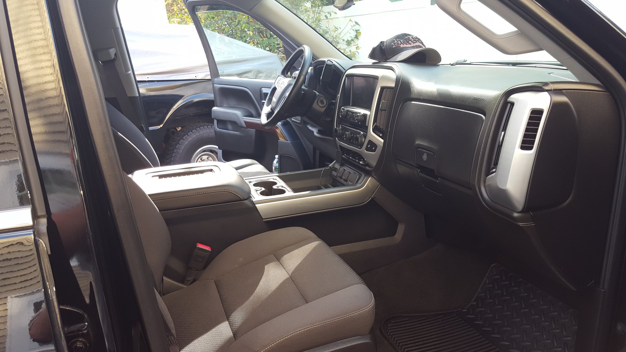

  1. Understood. I trust you are going to continue development though and produce them... I'll wait as patiently as I can. Meanwhile, I have mine in with the following functions: front 110v, two 12V and one USB. For now, this is just fine. We can drive and charge-up and I have the look and feel inside that I've always wanted. (I've been on the fence about buying one of these trucks for almost 2 years! Got this one in a hurry two weeks ago on a modest budget and in a hurry when another family vehicle got totaled) Anyway, I'll be writing up the mechanical part as I did it in case others follow on. For now here it is installed this morning. Note the Chevy silver side pieces... I need to swap them to the wood grain... if anyone knows where to find those as individual parts - Thanks!

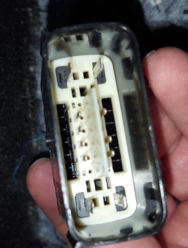

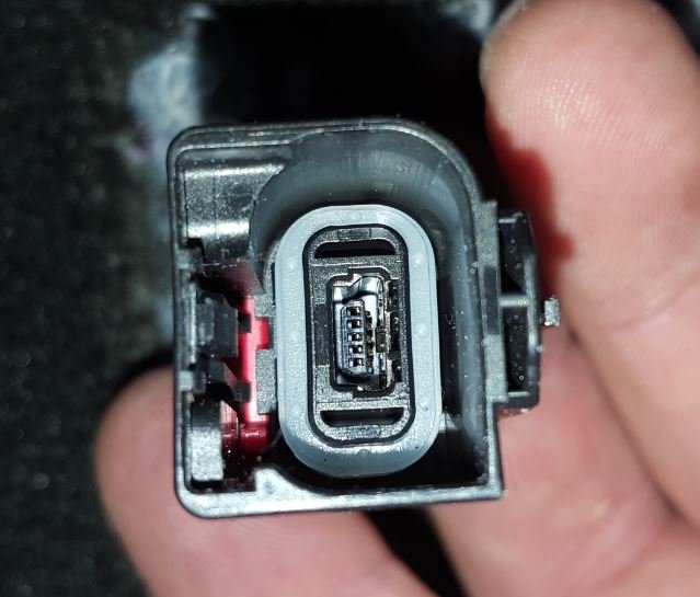

  4. Ok, it's on!! The passenger seat is unbolted and tilted into the back seat, the jump seat is out and the front ash tray panel is removed. Being a mechanical guy this was all too easy. I suspect removing the harness from the jump seat won't be too bad and that is next, but what I am really concerned about is the necessary wiring. I have a 2016 SLE but a bought a 2017 Chevy console with a charging lid. The first thing I find to be different from what is being described here by b18cx , pgambo and others is under my passenger seat I have this large connect and a usb, no 6 pin. Can anyone tell me if this is similar to what they've encountered? Thank You,
