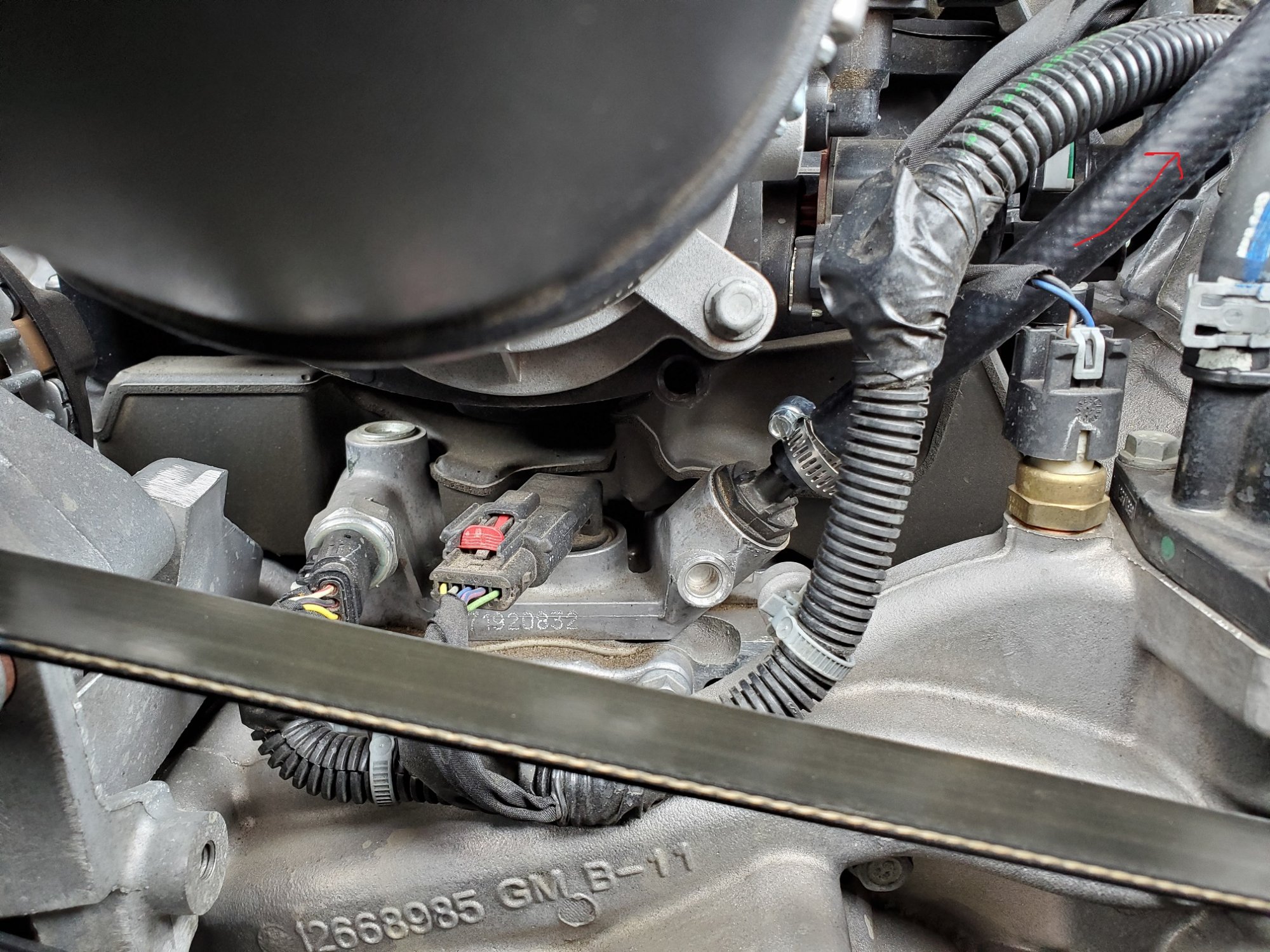

  4. Why the concern if the dealer sees it?

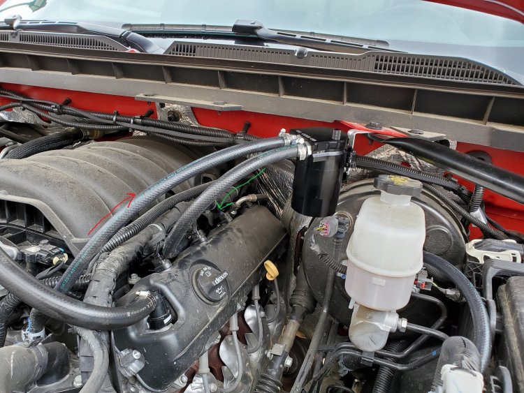

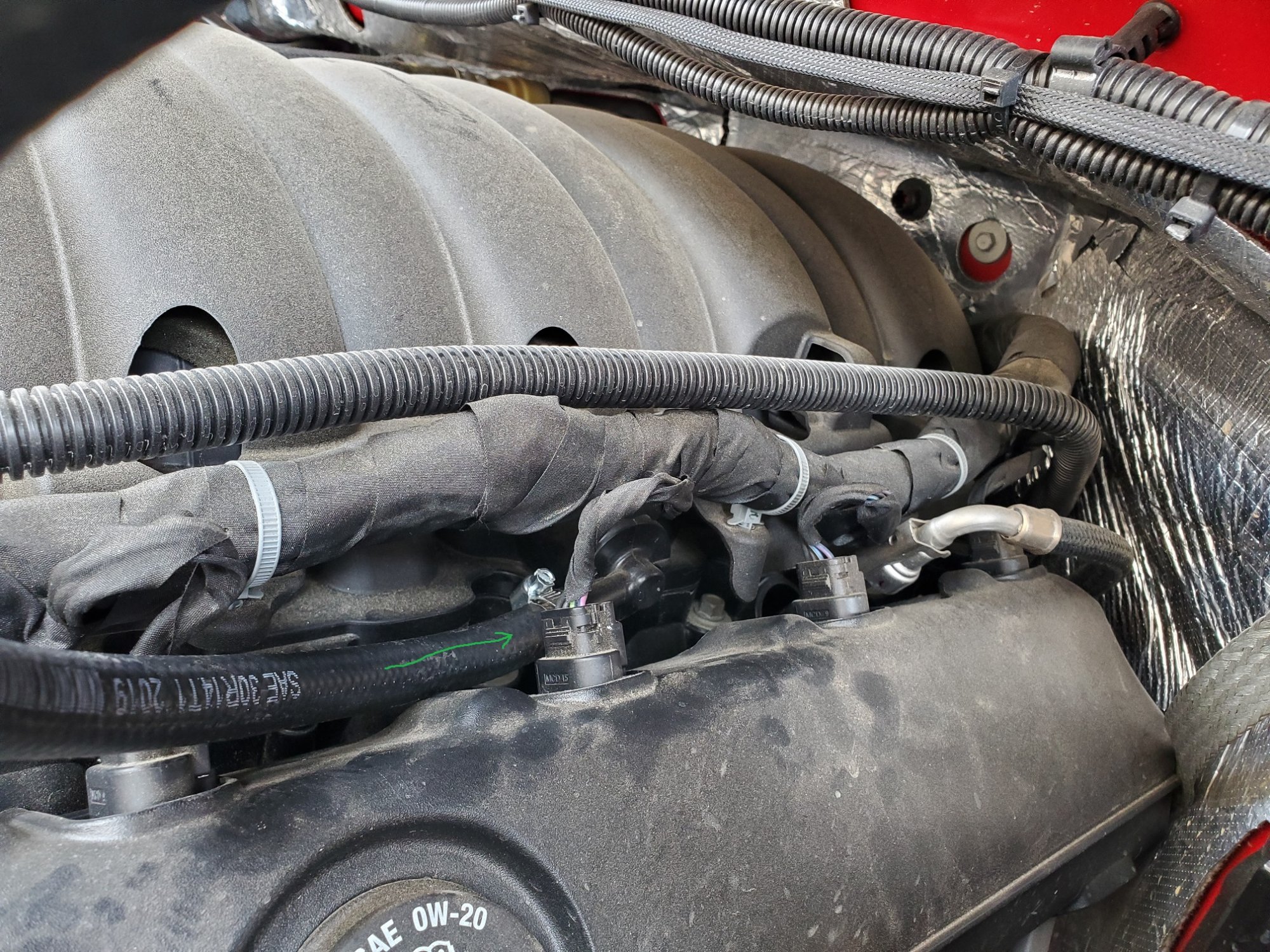

  19. Yeah, I totally had this wrong. What is scary is that nobody reading all this, caught it either! LOL Anyway, put the valve vent hoses back on the intake tube where they belong. They are drawing air OUT of the intake tube, not depositing hot oily air into it. The PCV hose is a single, short hose that comes from the top of the case, below the intake tube, and routes to the driver side of the motor, into the side of the intake manifold. I have pics of the catch can mounted with the hoses, and I marked the hoses with green and red arrows, so you can see the direction the air flows...
  20. I think that we have been looking at this all wrong? Those two lines coming off of the valve covers, are not the crankcase vents? Those are part of the emissions where the exhaust manifold draws a vacuum and this sucks in fresh filtered air from the intake tube, and inserts it into the exhaust in order to "clean up" emissions. Most of my motorcycles over the years have had suck a thing, called the "PAIR" or "SAI" system... That's not what is putting oil into the intake. There is a second system down lower, a single line as you can see in this video:
  21. So after even 100 miles, there isn't even a drop of oil in the catch can. There isn't even a slightly oil residue in there, which seemed odd. So I unplugged the hoses from the catch can, started the car and had my wife give it some throttle... The two plugs coming out of the valve covers... Those are actually drawing a vacuum at idle. There is no pressure coming out of them. As she revved the motor up you could feel some slight pulses in them, but they still seemed to be drawing a slight vacuum, rather than pushing any pressure. How is that? Where is that vacuum coming from? If that is the case, how would oil make it's way through that hose and into the intake manifold, which also, at 3,000rpm didn't seem to be drawing a vacuum. Now maybe at high revs it does, and the hoses coming off the valve covers reverse from a vacuum and do push a little pressure that the intake sucks up... But my 100 road miles... I tend to drive with a lead foot. I did the exhaust, intake mod, higher flow filter, Airaid MIT, SuperChips 93 octane performance tune with throttle sensitivity increased by 20%, etc... I have been hard on the gas to redline just to see if it would blow any oil into there, and it hasn't, not in the catch can... Anyone have any insight on this? Is it possible that the 18 models work differently than others?
