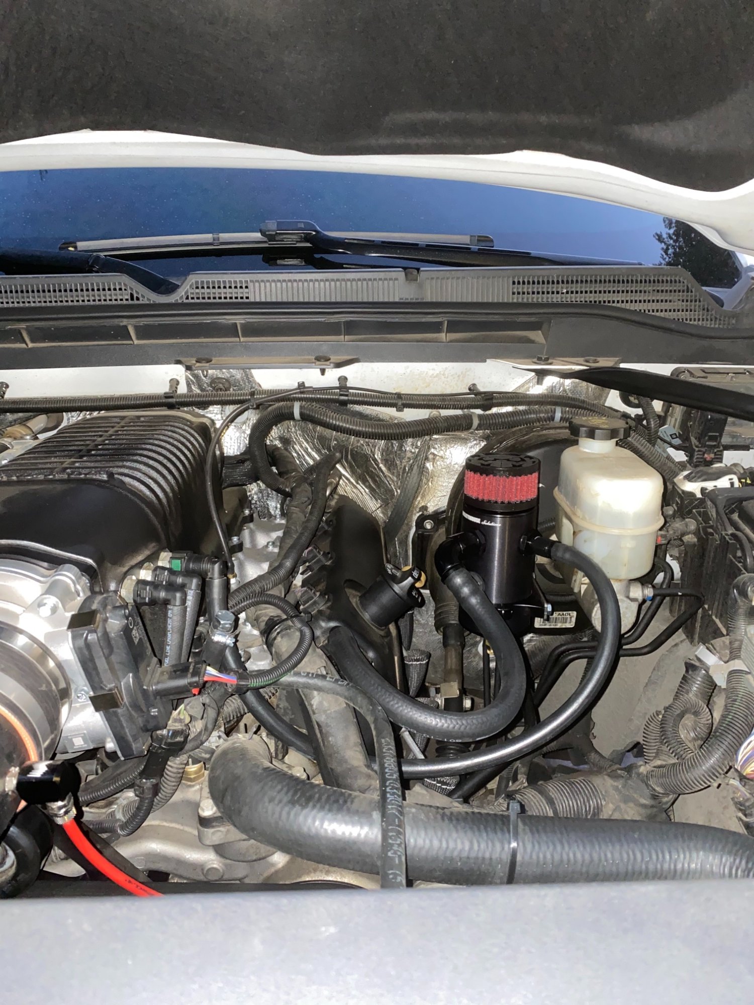

  4. The passenger valve cover breather tube is routed into the intake tube, Then the driver side tube off of the valve cover is routed into the catch can, and then the other hose from the catch can goes into the side of the charger. I will get pictures. I am running 0-20, I want to run 5W-30.

  6. My rear main seal keeps blowing out on my 2017 GMC 6.2. The truck has a 56,000 miles on it. The charger has been on it for 4,000 miles. Why does it keep blowing the rear main seal? I put a catch can on it and it still blew the seal. The catch can grabs about 5 ounces of oil for about 100 miles. That seems like alot. I have to constantly keep an eye on the motor oil. I am going to do a compression check on the motor to make sure the rings are not shot. Could it be a problem with the PCV system? PCV Valve not opening? Any input helps a bunch. Thanks.

  11. Yeah i have all the PCV hoses routing corectly.

  14. I bought a Wild Mighty Mouse Catch Can for my 2017 GMC Sierra 6.2, I am not sure if I need to cap off any of the hoses on the supercharger? I know one hose goes to the valley port. and the other hose goes to the valve cover. But I have seen in pictures that one of the hoses is removed and a plug is installed on the charger. Thanks
