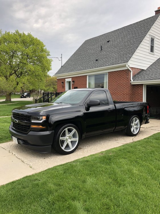

  10. Haven't posted in awhile - At least since I've installed my new wheels. 22x9.5 KMC Prism Truck in brushed silver wrapped in 285/40R22 Nitto 420S - Super happy with the look but dealing a slight vibration around 115-120 km/h - They were a bitch to balance so thinking I need to re do them or see if I have a rear bad tire. Also, finally removed the PF strut spacer to level out the front side to side and got my camber adjusted to a more respectable amount (-0.8 to -0.9) Full paint correction and ceramic coating too. Looking into going lower eventually. Would like to do 5/8 or 6/8 with twisted metal works upper arms, either their coil over kit or Belltech coil overs, then twisted metal works under bed notch with either Viking or Ridetech adjustable shocks - These Belltech SP shocks are just too damn stiff on these K2 trucks

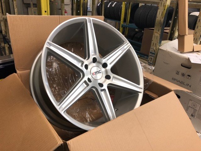

  19. Truck is still in storage, so sick of winter but I finally pulled the trigger on wheels & tires and they just showed up this week. Went with the new KMC KM712 Prism Truck in brushed silver, 22x9.5 and 285/40R22 Nitto 420S They actually have a slight concave that doesn't really show in photos and the finish on them is wicked I also got some 90's GM N90 wheel centre caps gel stickers made up for them that should set them off really nicely. If not, I'll get some gold bowtie ones made.
