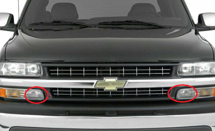

  4. 2002 Silverado. The top row is low & high beam. Low beam stays on while truck is running. The bottom row is blinker/blinker/???? The inner 3rd light does not turn on. What is that called? What it is even for, before I replace that bulb? I pulled the bulb out, and it's got a square base socket. Is it one of these? What's the difference of these two ? Parking Light Bulb Size: 3157A Daytime Running Light Bulb Size: 4114LL I just looked at the old bulb. It says 4157A on it. So, it looks like 3157A What is the "parking light" for ? When does it go on? https://www.gmtruckclub.com/threads/bulb-sizes-for-99-02-silverados.27092/
