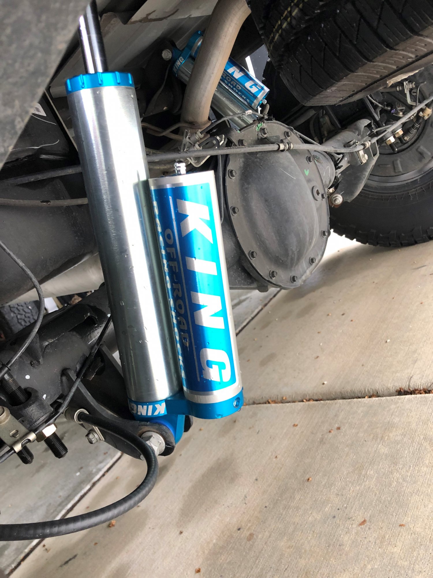

  1. There is a brake line bracket on the driver side frame rail preventing the shock from being mounted right side up. These shocks can be mounted either way.

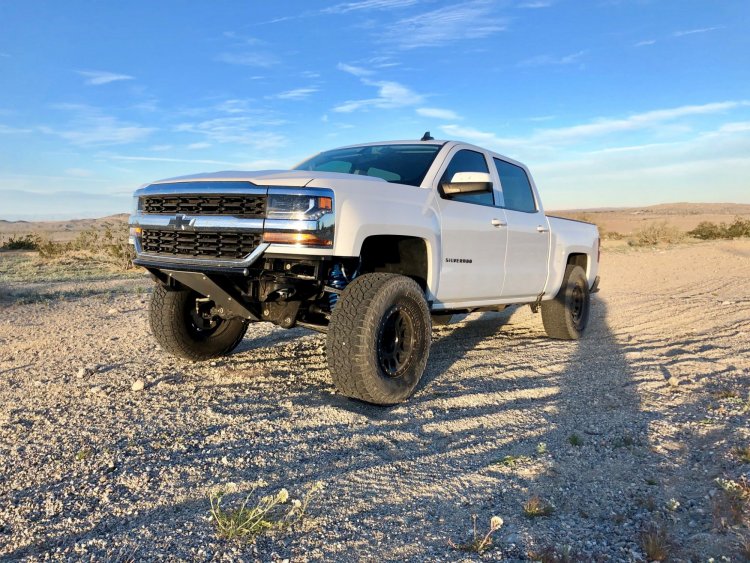

  4. Thanks! Yeah, King OEM coilovers, Dirt King UCAs, and CST 3.5" spindles on 315/70r17s. I am in San Diego, picture is at Ocotillo Wells.
