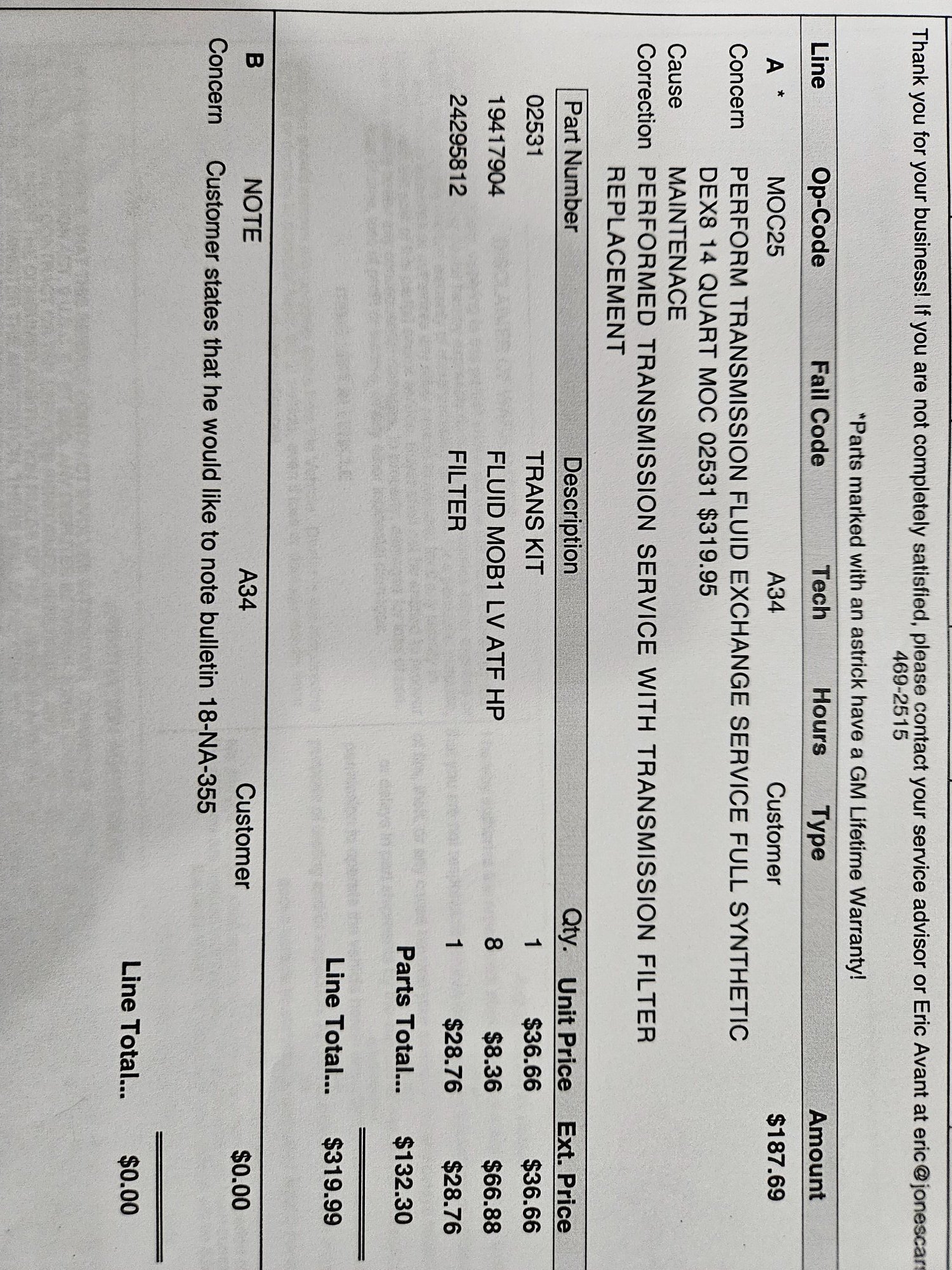

  2. Just got back from the dealer. I asked them to do the flush per the TSB. Instead, looks like they did the same thing I did 80K miles ago... Filter change and refill as they only added 8 quarts. I'm happy I have a new filter in... Not so happy I still have old fluid in. It was $340 tax and all.

  4. The TSB was never done... Never had this issue until now.
  5. 113k miles Pans dropped, filter changed and fluid refilled I have not messed with the thermostat. However, the trans doesn't go above 185 or so under normal use. I don't tow much
  6. At about 30K miles, I dropped the pan and changed the filter and refilled with fluid. I understand this is only 25-30% of the fluid, but it isn't all factory fill. What sucks is that I don't really abuse this truck. I have a boat...4500lbs total and I have done a couple of long distance trips with the boat, but I don't abuse the tranny. I've only had the boat for two years. Anyway, I am tempted to do the flush, but I'm afraid I'll spend $800 only to end up doing a rebuild regardless. Tough choices ahead...
