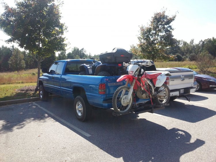

My old Dodge. First picture is my Zombie Apocalypse set up. 2nd picture was later, using the Pappy-Cap to support my son's BMX racing (keeping stuff out of the rain and theft prevention). 3rd picture was all my middle son's bedroom stuff on the trailer hauling it to said apartment, some in the bed and the back seat is full (can't tell). I played tetris with all the furniture and got it all packed down artfully on that trailer, with shipping blankets, nothing got damaged or scratched. Long bed was very handy.
