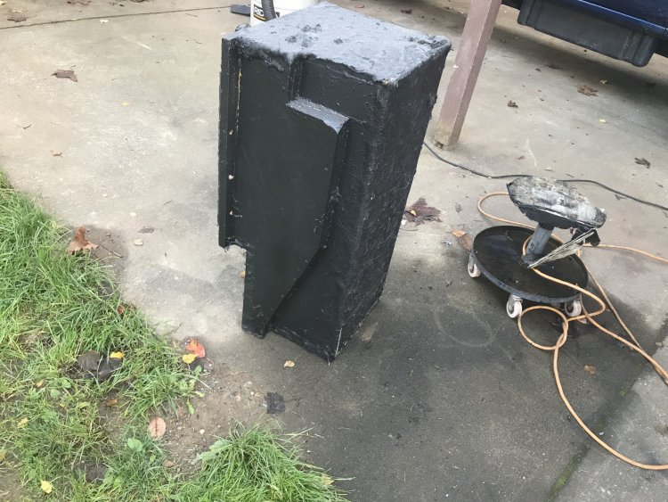

  3. Yes - I guess its been in there a year now and I've had no problems at all, sounds great and can still store a lot of stuff under the passenger side. I've been hot rodding for years so it was just a typical fab job for me, but I have to say if you brought it into a custom professional it would be a very expensive project. When its time to sell the truck I will just build a sheetmetal plate and bolt and seal it in you'd never know it was there unless you pulled the back seat out and pulled the carpet up and even then so what ? It will be a 150k mile truck when I sell it and it won't even mattter. I'm super happy with this solution. Here's a pic of the cabinet before it was mounted underneath the truck. You can see it has been shaped to fit around the fuel lines on the frame rail side.
  4. Or you could do what I did - Sub floor mounted 2.5 cu ft subwoofer box, Alpine Type-R 15", uses a minimum of under seat storage area. The box fit right in front of the fuel tank and after covering it with fiberglass and undercoating it looks almost OEM (and you only see it if you crawl under the truck). Obviously a major fab job including cutting a 12" square hole in the floor but I thought someone might find it interesting. (hole was framed with 1/4" steel and is much stiffer even with no box mounting than the original 20awg flat steel in this area. Upper and lower box sandwich the frame and clamped with 12 bolts). Sounds awesome and will massage your brain out if you put on rap music. Funny thing is I'm all about hi fidelity and usually listen to light jazz, but I tend to get carried away with things.
