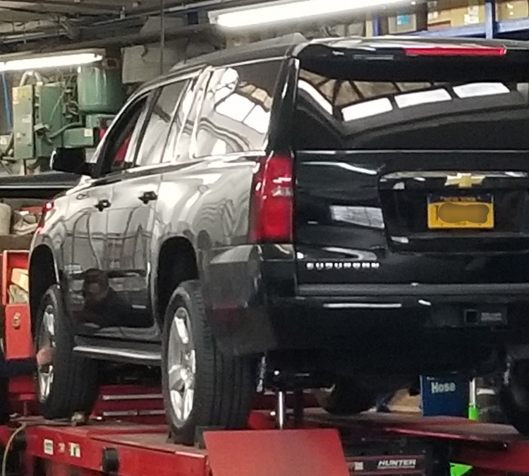

  4. I've been having an ongoing issue of my 2015 suburban going into Reduced Engine Power mode accompanied by a check engine light and stabilitrack light . This has happened in the past and it was a vacuum leak . However, this time I'm getting code P0191 (fuel rail pressure sensor). I've spent tons of money on the following Fuel rail cleaning Throttle body cleaning Fuel pump Fuel rail pressure sensor Checking wiring to the pressure sensor Plugs Wires Coil ECU After all of this I still have an intermittent issue of the truck going into a reduced engine power. It can happen twice in a day , or sometimes go 3 weeks without an occurrence, but it always happens. I carry a code scanner with me at all times because resetting the codes brings the truck back to life temporarily. Has anyone faced this same issue ? And if so what was finally the fix . Thanks people , any insight is much appreciated. Sent from my SM-G955U using Tapatalk
