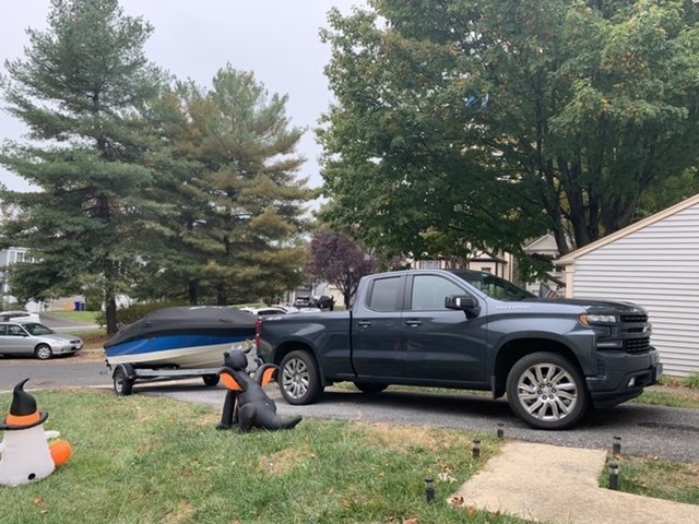

  7. Here’s mine, filthy and putting in some work on the worst day of the year for me (winterizing ?)
