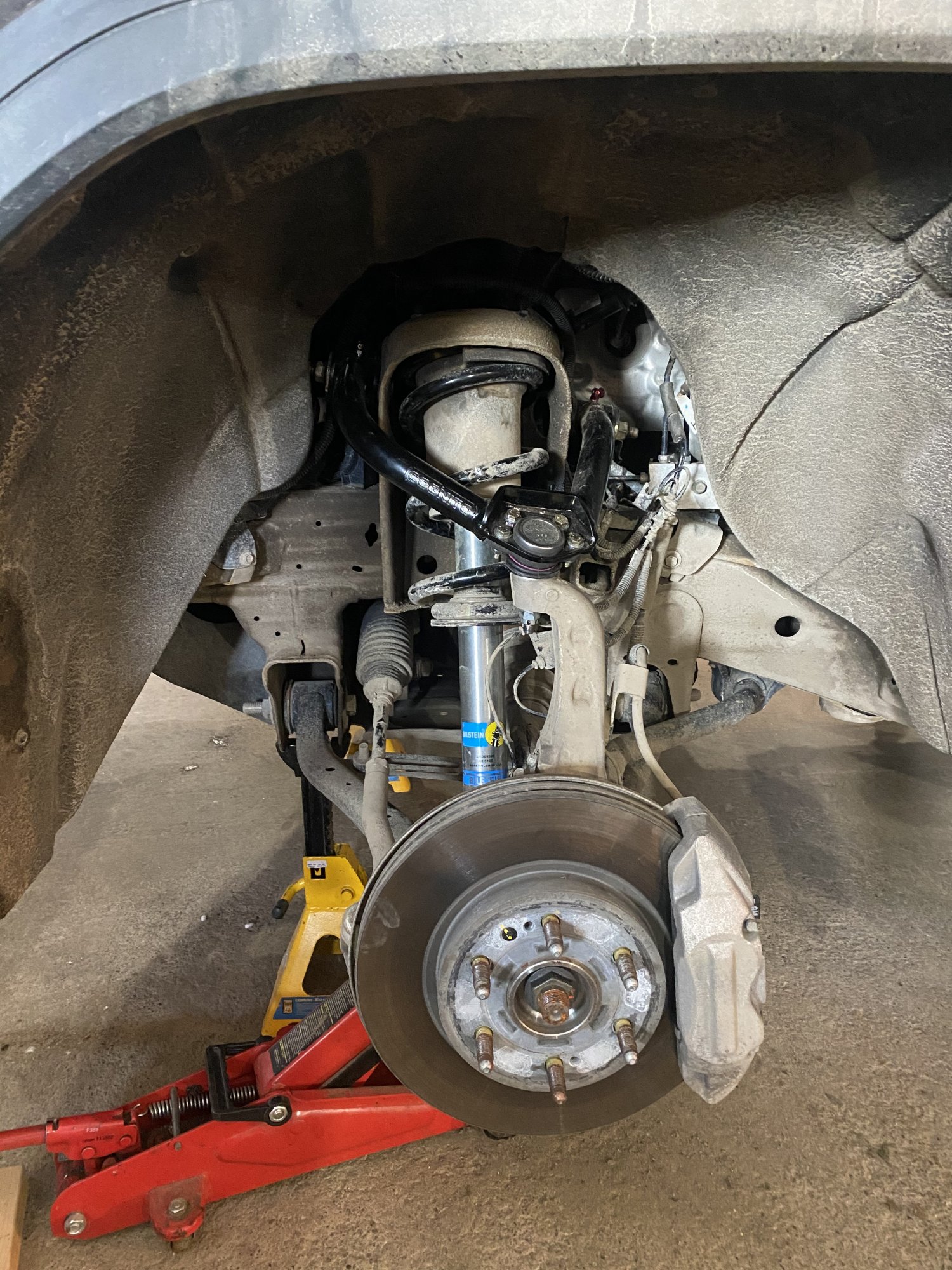

  1. I went with the bilstein 5100 set to the middle .55” setting. A 1” motofab lower block and some cognito UCAs. Sitting now about 1/4” low in the front on stock size tires. Originally it had 2” of rake.
  2. I went a similar route on my at4 but different components. Bilstein 5160 rear bilstien 5100 front set to middle .55” motofab 1” lower spacer cognito upper control arms seems to work well. Didn’t want to compress the spring to much so that why I decided on the lower spacers. This lifted me 1.75” and gave me a 1/4” of rake. I cut the droop stops off for the new UCAs. Ball joint angle is good and tire clearance with stock wheels is plenty. CV angle is no better off but not the worse I’ve seen.
  3. Front 5100 struts are available and give 1” of lift. I see also that the 6112 are available now as well and have an eibach spring but still require assembly
  4. I don’t think you would need to with only being 1.1” of list. Most guys are saying they start getting ball joint bind at 2” of lift. I’m probably going to go higher at some point or add a spacer depending on tire size so I figured I would put a UCA in now

  7. Yup max setting and a new UCA. should just go with the 6112 but I didn’t think the front needed to much help compared to the back. Should give me about a 1/2” of rake

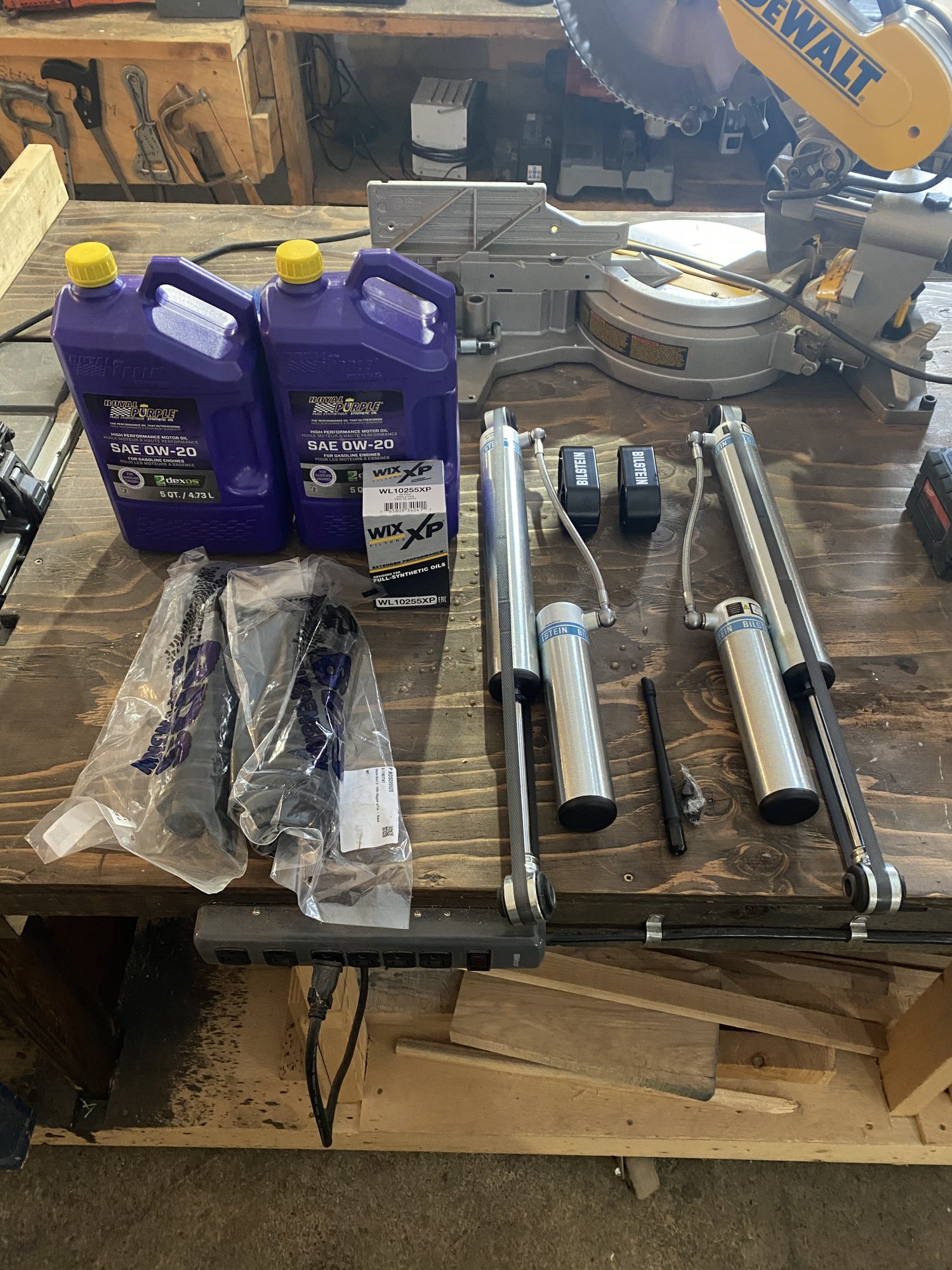

  10. Did the first non dealer oil change (finally out of free ones). Shorter antenna and then added some bilstein 5160 reservoir shocks to the rear.
  11. I added the 5160 rear reservoir shocks today and they make the ranchos feel like worn out junk. Planted this truck the way it should be

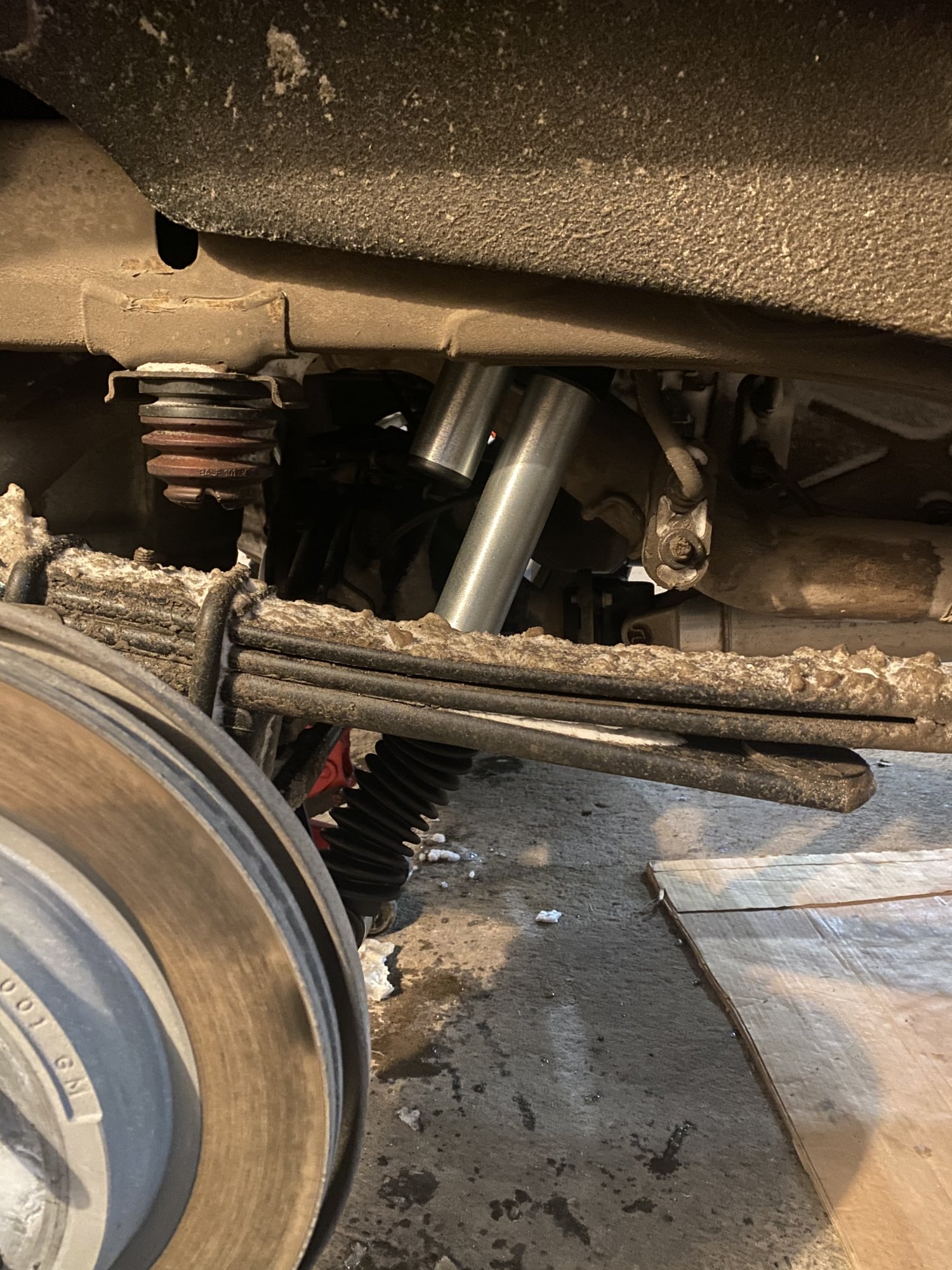

  12. Installed. The reservoir sits high and protected beside the frame
  13. Just installed the 5160 rear reservoir shocks and they blow the ranchos outta the park. This thing is planted now. On the fresh compact ice and snow roads and gravel the back end used to dance around to the point of slowing down. Now it’s planted and soaks them up. Can’t wait for my UCAs so I can put the 5100s up front.

  18. Ordered a set of Bilstein 5100 shocks for the front and 5160 rese shocks for the rear of my AT4. I’m planning on running them at max for the additional “ of height so I don’t need to use spacers or level kits to gain height. Just curious with the added strut height if I will need to install aftermarket UCAs or if the angle will be ok still. Anyone use these on there at4 or trail boss? thanks
