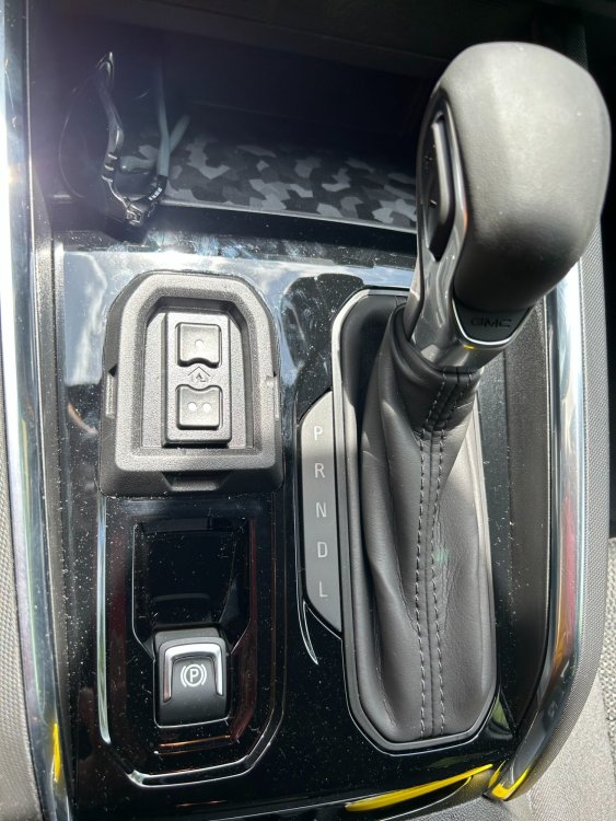

  1. Hey folks, Just picked up a 2025 Canyon Elevation and the packages that I opted for did not have a built in HomeLink transmitter in the visor, roof console or mirror. Since my Canyon is a 2wd, I was able to install a two button Gentex GENHLBP1 transmitter into the knock-out cover that fills the hole in the console face. You have to trim a plastic strap below in the console cavity to allow the transmitter some room to sit flush into the knock out cover which is held in place by four tabs. Worked out good as shown below. Bill.
