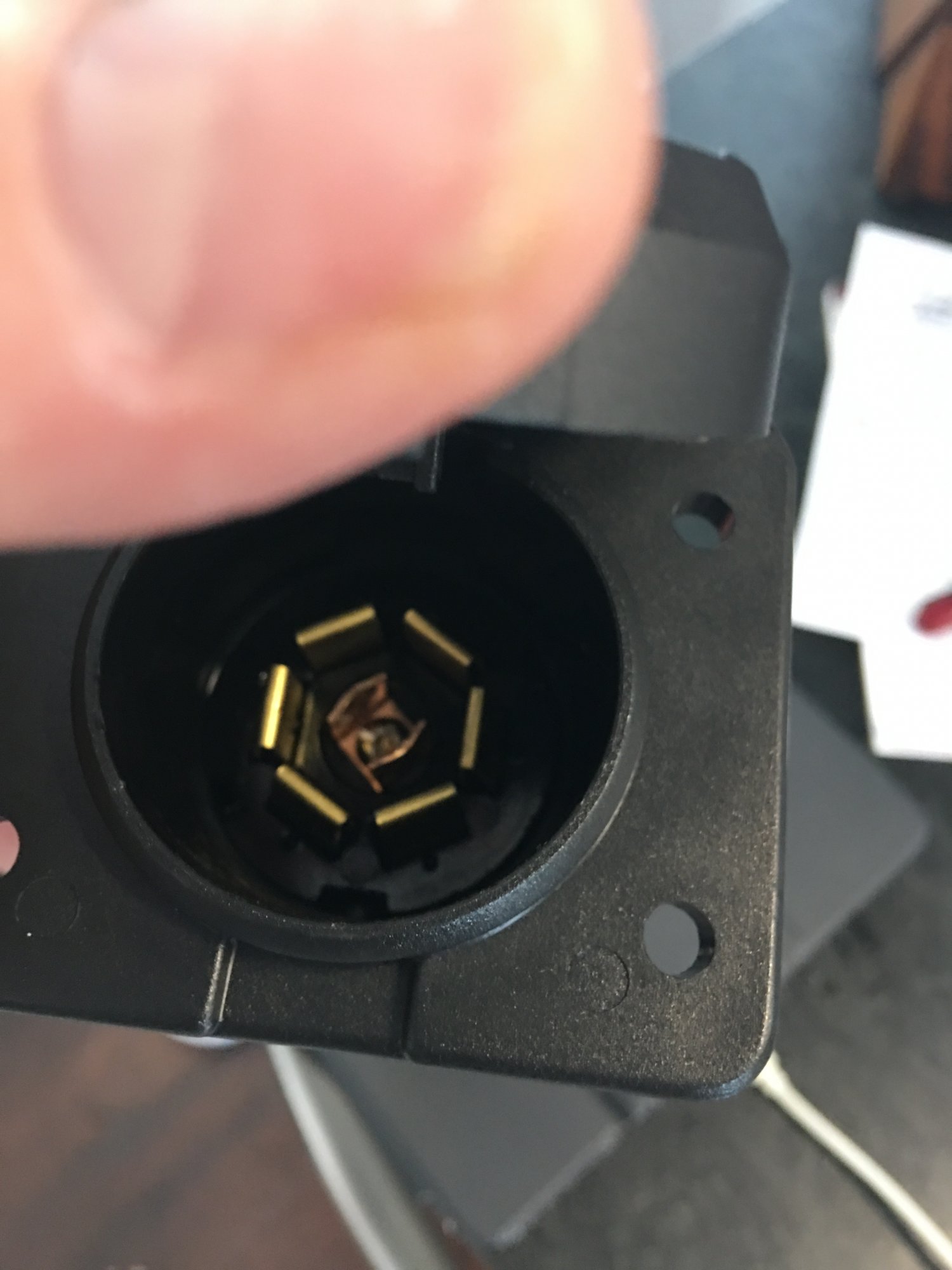

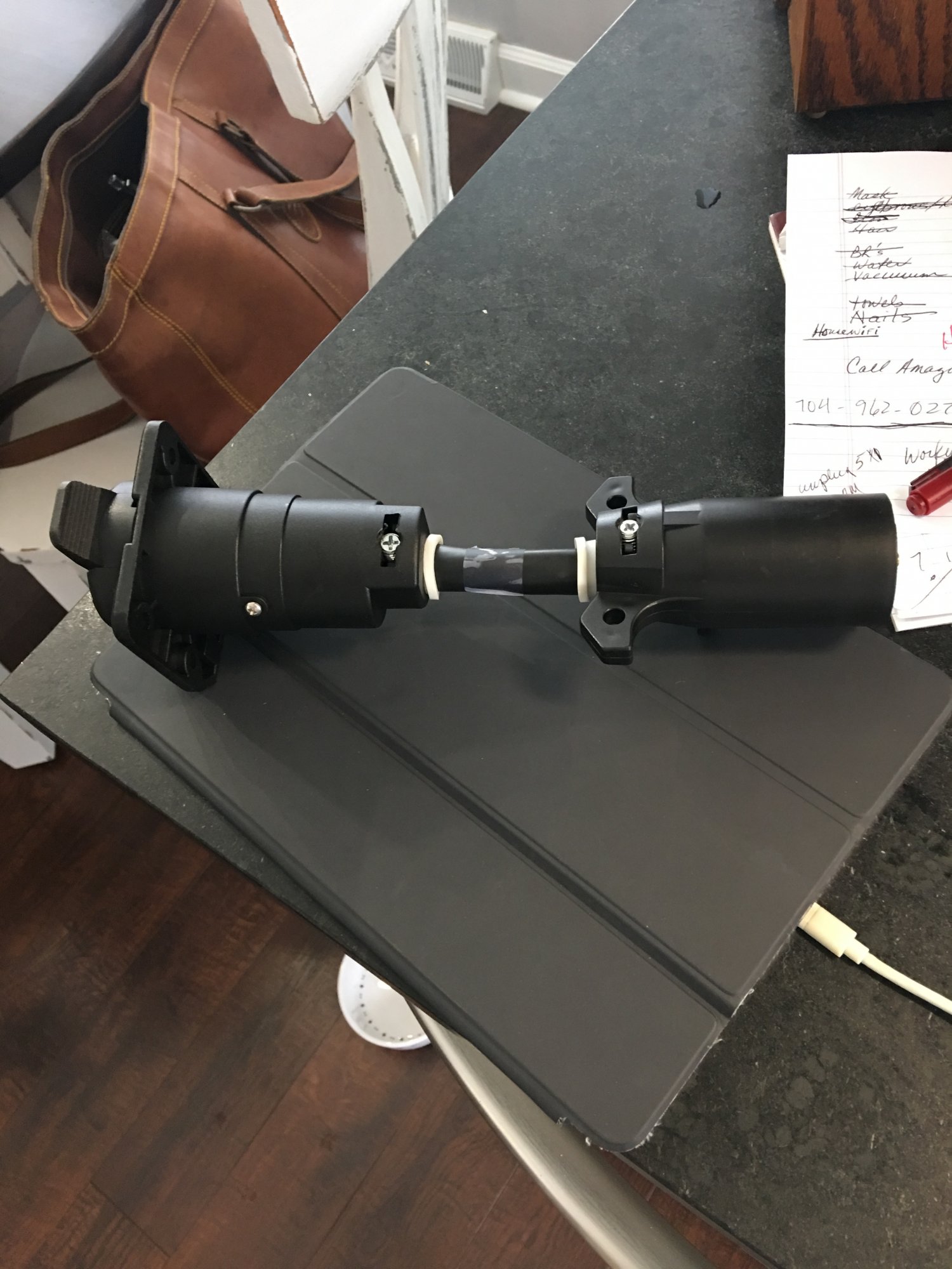

  1. Here is the Furrion adaptor (goes into 7 way). We love it. I will ask my husband about the trailer theft, but I do know all the checklists, etc work. We do the lights test, etc. every time.
  2. Here is the Furrion adaptor (goes into 7 way). We love it.
  3. Which type of Camera do you have? Furrion sent us a prototype and it worked great on a 6,000 mile trip! Solved the whole problem.

  5. Furrion is now working on an adapter that fits in your 7 way. It took care of our problem. They sent us a prototype and we drove over 6,000 miles without a blip! Contact their customer service department.
