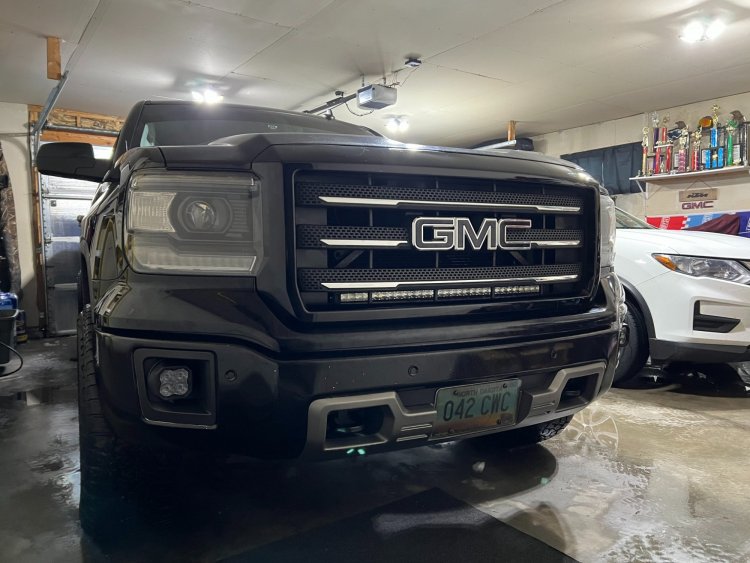

  6. I don't have any pictures during the install, unfortunately. I used a piece of 1/8"(I think? maybe 3/16?) steel that was 2-3" wide and roughly 36" long. Mounted the steel plate directly to the radiator support pieces behind the grille. Then mounted the light bar brackets to the steel plate. Fairly easy if you don't have active shutters, just had to use vice grips/clamps to mock things up before drilling/mounting both the plate and light bar mounts. This way I made sure it was spaced where I wanted it between the grille pieces. I have a cheap light bar I snagged from Amazon prime day, it's a Rigidhorse 32" single row. Don't recommend it, scatters light everywhere.. it's really only beneficial through the woods at night going slow. On dark backroads with no traffic my SS3 pro fogs outperform it. I've been eyeing up the Diode Dynamics 30" stage series bar but haven't pulled the trigger yet. I'm a firm believer in Diode's quality and performance, and when it comes to lighting you really do get what you pay for.
  7. Been a minute since I've done anything to my truck other than an regular maintenance. FINALLY, after 2 years of searching locally, found a OEM All Terrain grille. The cost (only $120) was justified by the condition.. lots of deep scratches down past the paint, which took me several hours to correct. Learned a lot during the process but happy with the outcome, even after dropping it and cracking the freshly refinished bezel . Luckily the crack is on the bottom and tough to see. Then had to move the light bar mount so that took awhile to fabricate.
