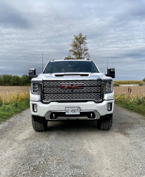

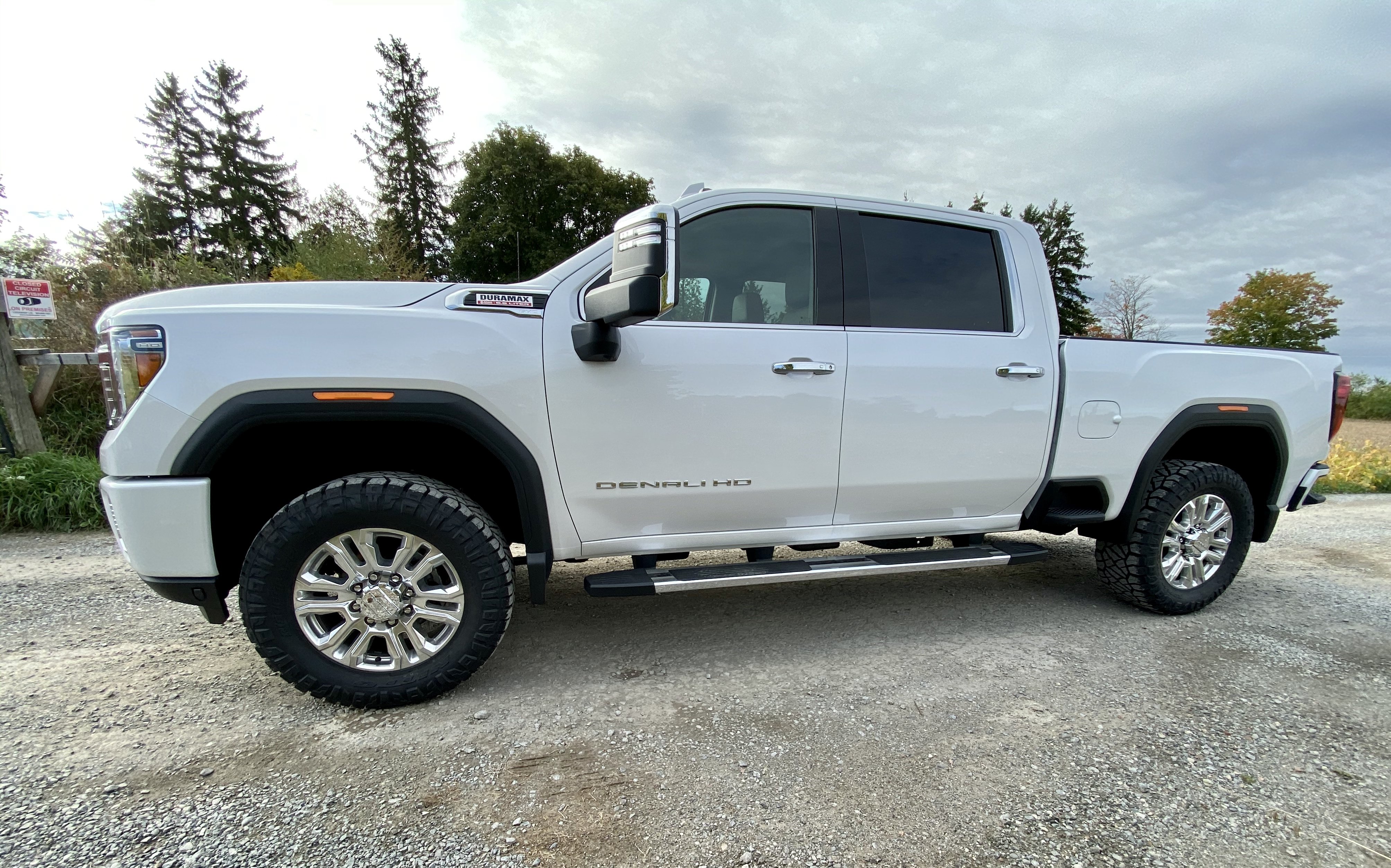

I have a 2020 2500 Denali Duramax with 2,000kms . From Day 1 I switched the tires to the Nitto ridge grapplers 35x12.5r20 so I did not set a stock benchmark for the ride quality
