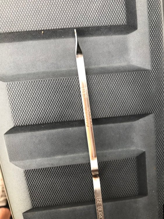

  12. Here is how the dipstick reads hot...it's almost up to the bend in the stick. Captain Obvious says that is too much fluid.
  13. 6-speed. Level checked at both cold and hot temps, and it is still high. Doing some reading I see that one of the symptoms of overfilling is "erratic" shifting, which is what I believe I have. It doesn't look like any major damage is done, so that is (hopefully!) good news. I'll be taking it in tomorrow to siphon out some more fluid...and will be keeping my fingers crossed.
