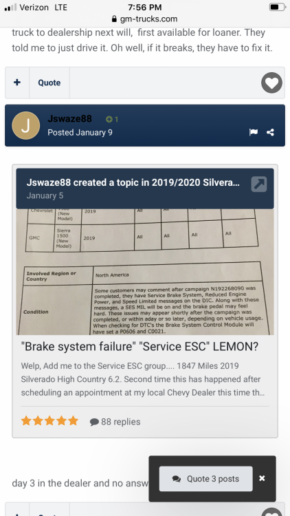

  21. TSB those are same codes I’m getting Service ESC code C0021 code P0606
  22. This happened to me today. First time. After remote start. Using MyChevrolet App on iPhone 8 ios 10 recall work done in Dec at routine oil change. four messages: Service ESC Service Trailer Brake Brake System Failure - 62 MPH Top Speed Steering Assist Reduced Drive with care Lights on dash that were illuminated ABS  Check Engine BRAKE Traction Control brake pedal diminished only push down 25% turn off. open door close door errors go away. engine light on Codes P25A2 P0606 C0021 called OnStar. They said all systems showing failed. go to dealer. did it again After remote start. this is showing up on several forums. dealer on Monday.
  23. 2019 Chevrolet Silverado mileage 13k recall work done dec. today after remote start I had four messages: Service ESC Service Trailer Brake Brake System Failure - 62 MPH Top Speed Steering Assist Reduced Drive with care Lights on dash that were illuminated ABS  Check Engine BRAKE Traction Control Hard to brake, meaning brakes do not function. threw codes P0606 C0021 P25A2 i have to turn off engine. open close door restart errors go away engine light stays on Going to dealer on Monday.
