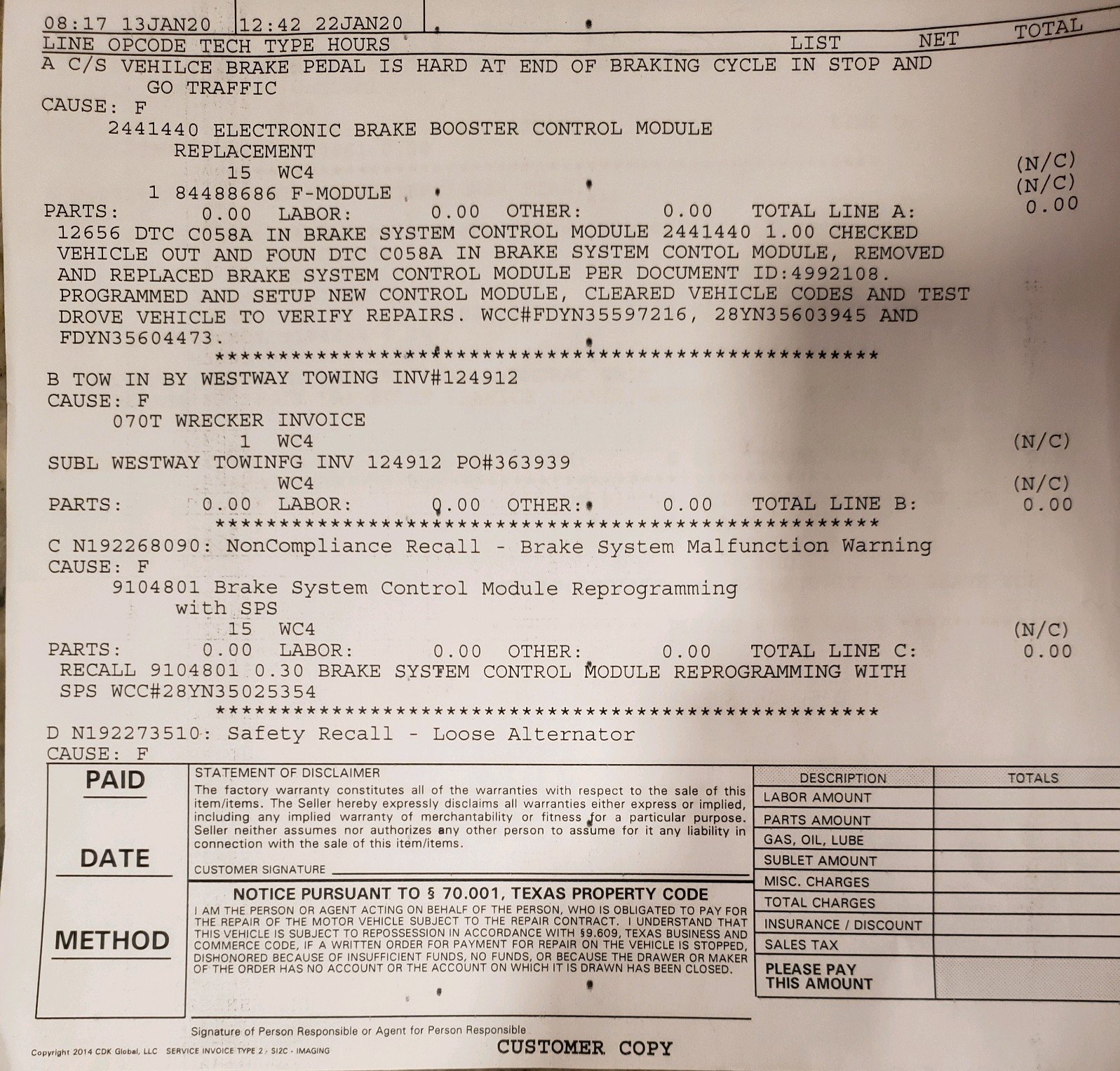

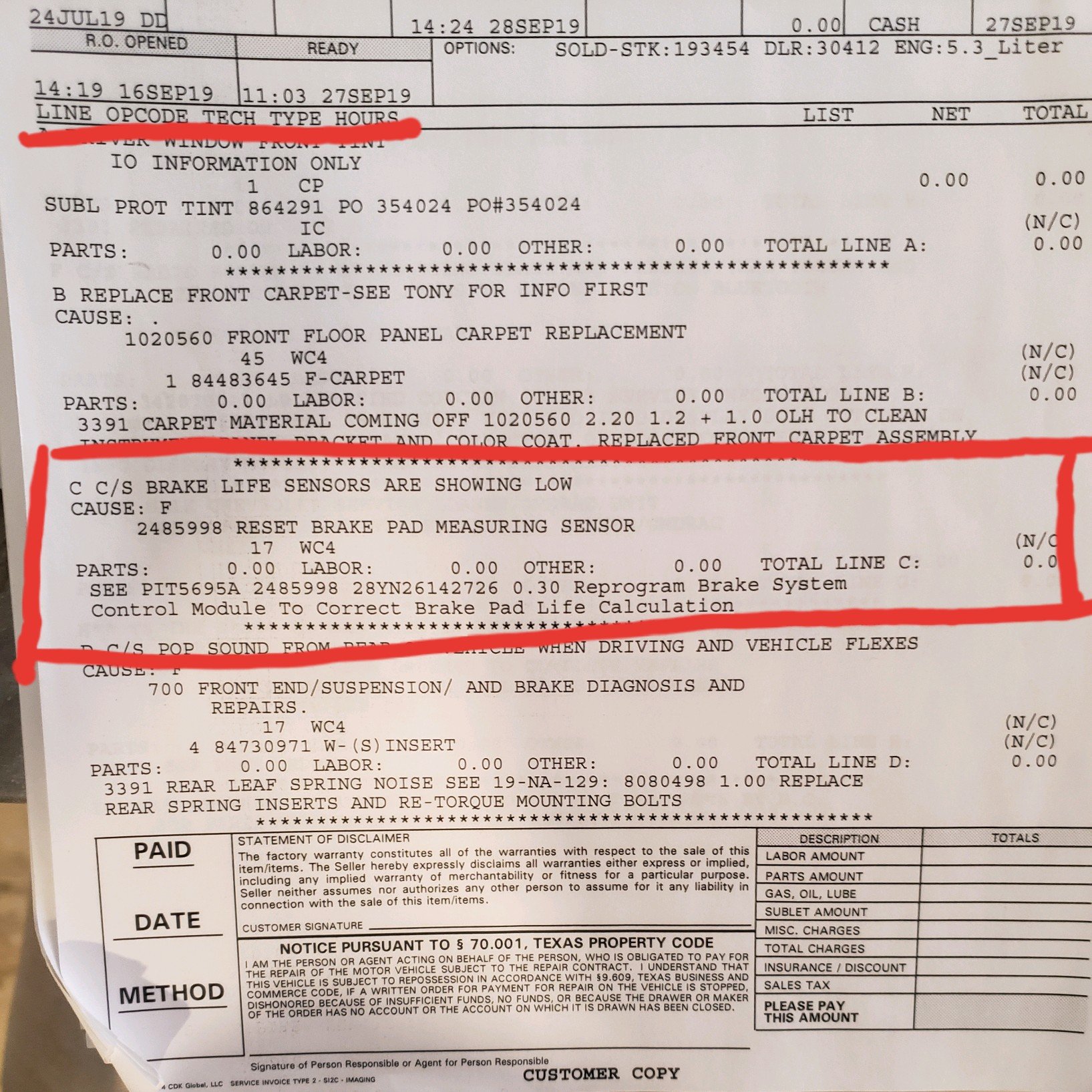

Sorry for the extensive posts and photos but, here is some background info that leads me to believe GM truly does not know how to fix this and issues I have experienced with PIT 5728B. I have never used the MyChevrolet app to auto start my truck. Most of you experiencing the brake failure have and that was the reason GM gave for the failure. I have used the FOB a handful of times. Another reason they gave was the brake re-calibration. I had my brakes re-calibrated to read properly back in September of 2019 at 3,079 Miles. My brake failure occurred 4 months later at 12,575 Miles. Seems unlikely that, that would be the cause of the brake failure. After I received the TSB PIT 5728B, I started to have a tapping feeling against my foot coming through the brake pedal when I would stop. The only other time this has happened to me was when my brake failure occurred on 1/10/20 and in my 2010 Silverado when the ABS needed to be serviced. My radio screen now cycles through dim, medium, and bright simultaneously at random while I drive (no, it's not because a difference in lighting outside is hitting the sensor causing the brightness to change). When I come to a slow, very gradual stop my brakes give like the ABS is kicking in. They then re-apply and cause me to come to a jerking stop, but hey at least I'm stopping. This all occurs within a second but, I fear at one point they will not re-apply. This next event has only happened to me once now but I am curious if it has happened to anyone else. I was stopped at a stop sign and all of the sudden I heard a low rumbling coming from the rear of my truck and the entire thing started to shake. I released my foot off the brake pedal and it stopped. It has not re-occurred. -
Anyone lost brakes besides me.
Forrest_E replied to midriv's topic in Troubleshooting, Warranty & Recalls
If you have PIT 5728B PLEASE go back to your/a dealership and have them re-scan it for error codes after driving it for a few days. I have been following this thread for a while now and figured I would chime in. I experienced brake failure in my 2019 LT Trail Boss on 1/10/20 at 12,575 miles in heavy traffic. I had luckily just slowed down to about 10-15 MPH when they failed and was able to make it over to the shoulder to coast to a stop. If I had the failure 20 seconds earlier I almost certainly would have been involved in a fatal car accident as the car ahead of me was at a dead stop. The dealership "fixed" the issue the following Monday but wanted to take it for a test drive the next day because people were still experiencing failures after the "fix" which was to replace the vacuum pump. They had a brake failure on the test drive. The next step was to wait for a new brake module and reprogram, which they did with PIT 5728B. I informed the dealer I was not comfortable driving the vehicle nor did I have any trust in this "fix". I asked what would happen when they fail again since they have now provided at least 6 different remedies for this serious issue. They pretty much just shrugged their shoulders and sent me on my way. If you have PIT 5728B PLEASE go back to your/a dealership and have them re-scan it for error codes after driving it for a few days. I went to a different dealership today because I have been having a variety of concerning issues with the brakes and the dealership I purchased the vehicle at was blowing this off as if it's not a serious issue. They scanned my vehicle and found a brake malfunction error code as well as two others. Unfortunately, I did not get a print out of those errors. They cleared the errors only to have 4 others appear which I will attach to this post. The dealer said I have the the absolute most recent fix but they were unable to reprogram the brake module and weren't sure what to do. My truck does not have the new GM recall #: N192268091 that was released on 1/30/20. They are stumped and will be contacting GM on my behalf and what to do with the truck. I already have a case open but, GM has ignored me after my initial conversation with a senior advisor requesting a buy back or swap. She sends me emails stating she tried to contact me yet I never have a voicemail or missed call from her while I have tried numerous times to contact her by phone and left voicemails that she please leave a voicemail if I do not answer so I know she truly attempted to contact me. I refuse to let GM push this brake failure under the rug. They are putting our lives in danger as well as everyone else on the roadway that does not even own a Silverado or Denali.
