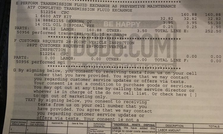

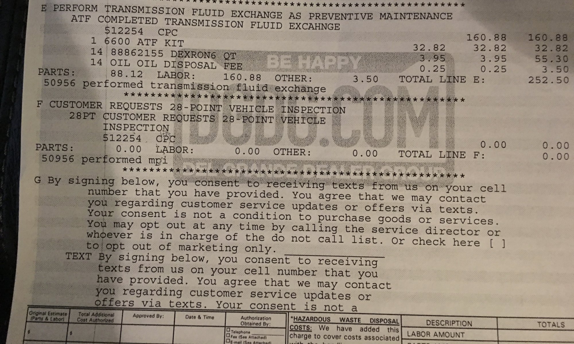

  8. New to the forum. I have a 2015 GMC Sierra 1500 SLT 4WD 5.3L Gas engine with the 6 speed auto. Just recently had the transmission fluid exchange (flush) done at my dealership, with ~ 51,000 miles on it. So far I noticed much smoother shifts and quiter all around. You can see the total cost was $252.50 (I live in CaliPOORnia and do not have the means to do a fluid change myself). When I asked what this entails he said it completely exchanges out the old transmission fluid replacing it with new fluid, including what is in the torque converter. He then said at ~100,000 miles they can do a fluid change, including the transmission filter. However, I noticed one of the line items in the details is '1 6600 ATF Kit'. When searching this nothing definitive comes up, but seems it could be a cleaning agent they use. Thoughts? Anyhow, as mentioned earlier so far so good using the flush. From what I gather doing the flush with relatively low miles, like on my truck, is okay, just don't want to do it with higher mileage, since can push dirt and debris that have accumalated over time into places where it shouldn't be. It's my opinion doing regular fluid changes will be beneficial in the long run, despite the manual saying can go to 150,000 for non-severe duty, which I think they say so people think they will save $$ by waiting that long, but seems that would be asking for trouble, and better to do more frequently.
