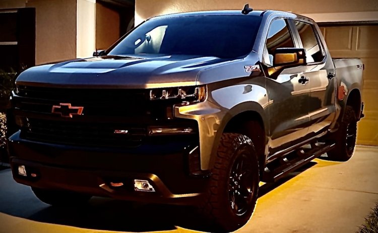

  2. Finally got some good pics of mine. Man this truck looks mean.
