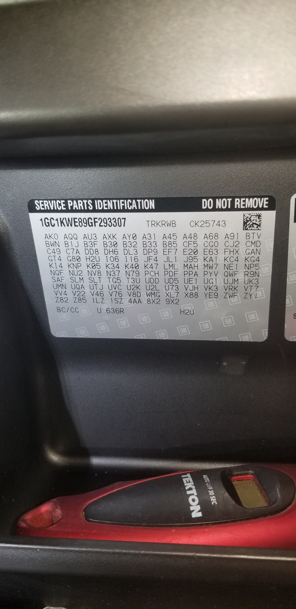

  1. Yes the red blinkers work. No I'm the second owner of the truck. I do have the higher trim package, so I would assume they work at one time. Well I look at the RPO code and this is what have. I don't see DL8, but do see DL3 code. So does this mean the previous owner upgraded the Mirrors? Just a note: the previous owner had a 5th wheel ball attach in the bed for hauling a horse trailer. It was removed from the truck when I bought it. I bought the truck from a dealer. Can the light be program to come on with a scan tool from my buddy at the body shop? He said it's a high end one and it cost 10K. Thank you for getting back to me, I really appreciate it. Scott
  2. Could someone help me in trying to figure out why I can’t get the rear view extend mirror guidance lights to work. My understanding is that the rear cargo light needs to be on along with shifter in Park, Reverse, or Neutral. I have checked the fuse and it good; the Cargo light is coming on. I took apart the part Mirror this morning and took the rear guidance light and hook up to a 12V battery- work great. Only other thing I can think of is wiring from Mirror to wiring harness block. 2016 Chevy LTZ ,4x4, 2500, Diesel Additional questions: On the Pink BCM wiring #26 - What fuse does it go to? On the Black BCM wiring #26 - What fuse does it go to? Has anyone upgrade this light?
