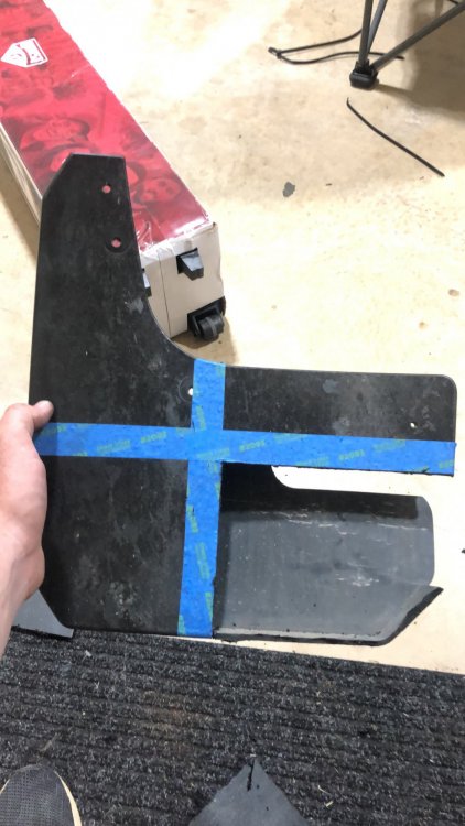

  3. This is how I cut my mid mud flaps after pulling the liner back. I still rub a tad though. I’ll need to either do more trimming or try and pull it back a little more

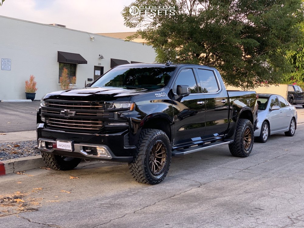

  4. Fuel Rebels 20x10 (w/ -18) 35x12.50x20 Nitto Ridge Grappler.

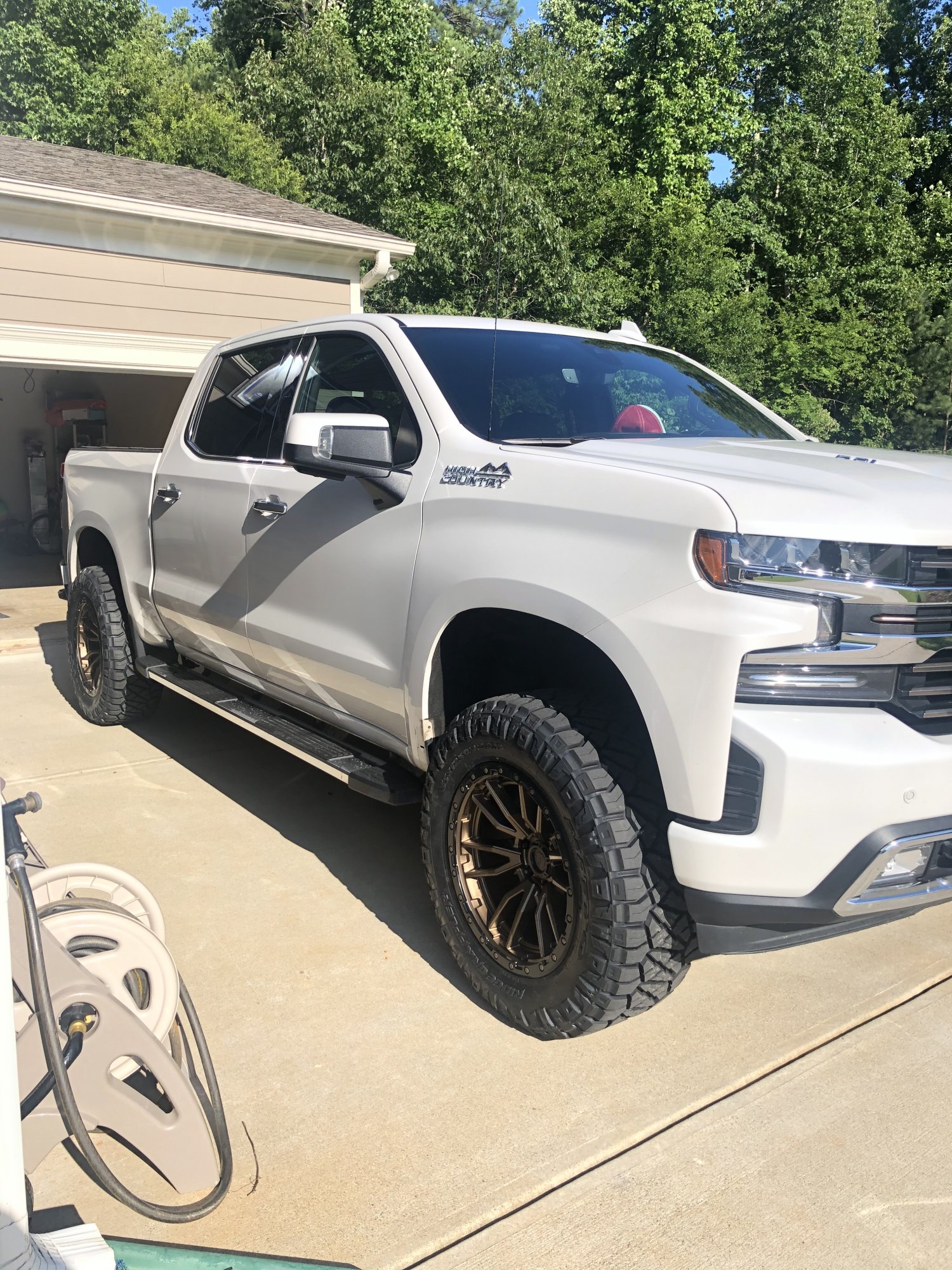

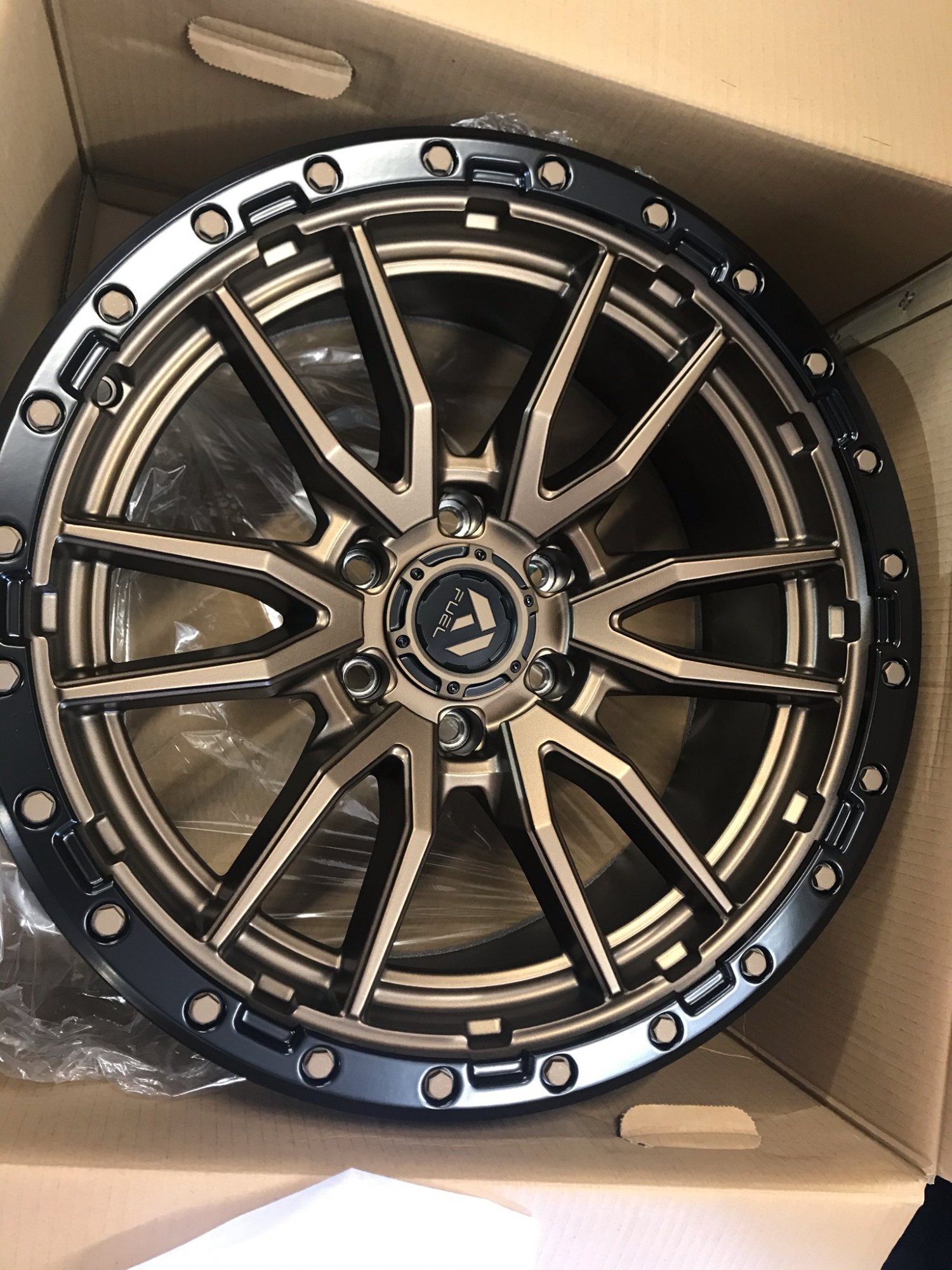

  5. Lift is in, tires are in, but they shipped 3 wheels ??. 4th should be here today so I have to wait until Monday to install.

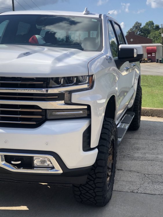

  7. @topgear1224 I don’t plan on doing much off-road with this. I have a RZR for that ?. i ordered the 20x9 fuel rebels with 35x12.50x20 ridge grapplers. Should be installed weds or Thursday. I’ll post pics

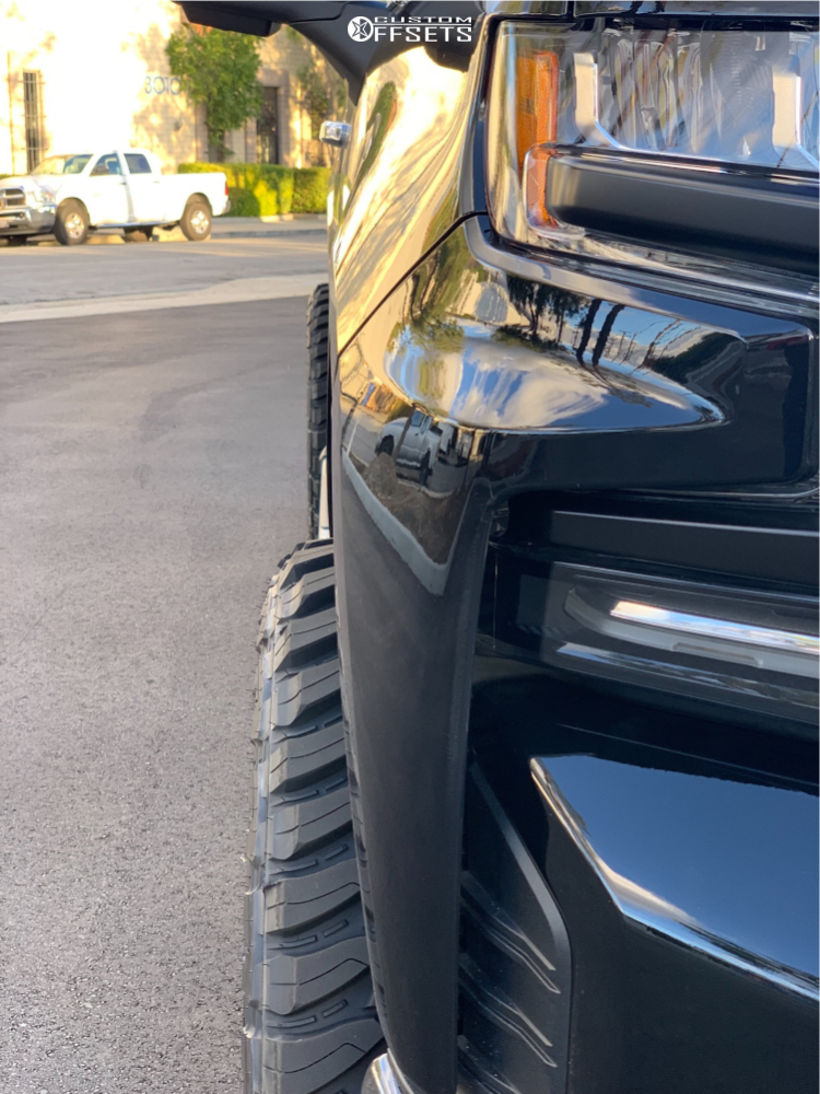

  8. Has anyone attempted to put 35x12.50x20 on their truck with this lift? The wheels I am looking at are 20x9 with a 1 offset or 20x10 with a -18. But ReadyLift says 20x9 0 Offset and 35x11.50. I'm assuming that requires no cutting or fabricating? I think wider is better (obviously not always the case) but its hard for me to visualize the 20x9 and 1 offset. How much poke would it have? How much cutting/fabricating would I have to do to get the 20x10 and 35/12.50's?
  9. @Dirtbiker Thank you. I looked at fuel's website and they show 20x9 is either a +1 or +20. But the 20x10's go to a -18. @BlackRST Did you do a lift or is that stock?
  10. @loud_pipes I just realized you're running at 12.50 tire. So you have no rub issues? From what I was told I needed a 20x9 and an 11.50 tire. On 35's, maybe thats the difference?
