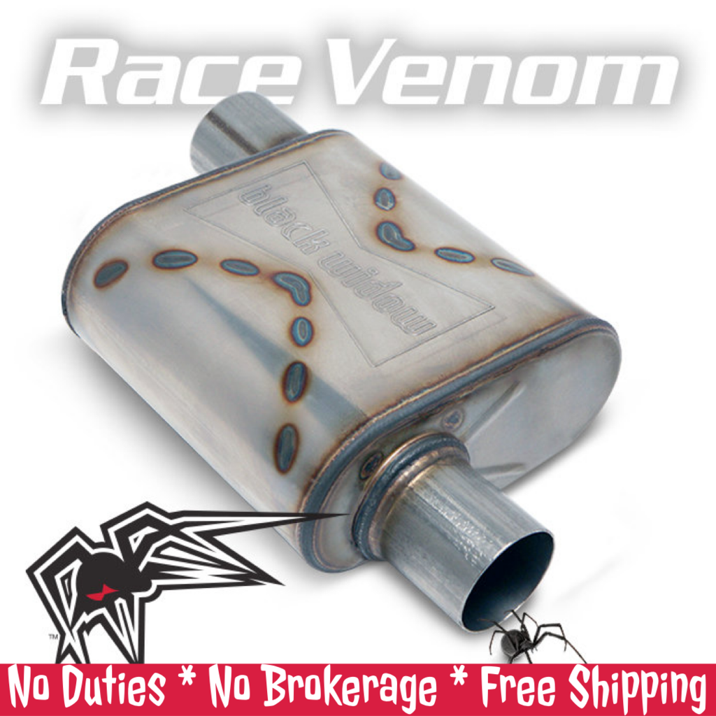

  7. Yeah, I can only speak to my truck. With the duals rear exit . I know some trucks have side exits. But these trucks are well sound insulated. Quiet in the cab. https://www.blackwidowexhaust.com/mufflers/Race-Venom-3-offset-offset-SKU-BWOOR-33-p108144418

  16. Curious On this . These “Catback” exhaust systems are just that, from the cat back replaced. why pay all that money to replace GMs OEM piping which is already stainless! The only gains you Get are from the muffler swap , taking the old muffler out with the flappers and replacing with a high flow muffler no flappers. essentially that 13 HP gain for $2000 dollars can be had for around 200-300 dollars. save your money people, replace the muffler you will get the same gains and sound or better lol. as far as a cold air intake , get S&B , Volant or Cold Air Inductions. They make much better design intakes and filters. Disconnect the negative battery terminal during installation. This resets the ECM so it can re learn the fuel trims . No need to get GMs “Tune” . Its not a tune.
  17. Also just a note the angry Housewife is just a shorter race venom , apparently its not quite as loud as the regular race venom , but a little less raspy. (I like the rasp in the race venom) Stock right now is pretty crappy but looking underneath the truck I recommend an offset-offset or an offset center. 3”. delete flapper 100%.
  18. I had a race venom in my 18, I bought another for my 2020 . Getting installed monday , deleting the flapper and resonators . on my 18 it sounded fierce. Every time I went somewhere people asked me what I had in her. I will let you know Monday how she sounds through the duals
