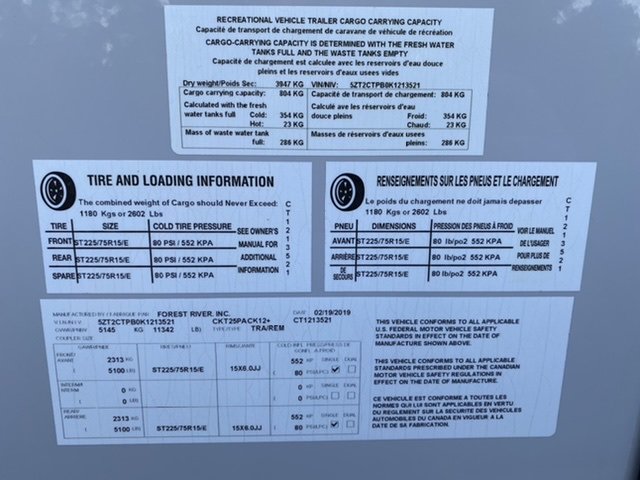

  3. sorry but i'm just unknowledgeable on this stuff.so counting my hitch weight and all passengers plus whatever i'm carrying i can't go over 3196lbs?how are these guys towing these huge 5th wheels with the same truck? are they just overweight?
  4. Yes it’s a conventional bumper pull. I see guys pulling these toyhauler a way bigger than mine with the same truck. Are they overweight and not caring or can you increase what the truck can do
  5. So i just bought a 2020 2500 LTZ duramax to haul my 38 foot toyhauler. My question is what is my truck capable of pulling if i ever decided to go bigger? My door sticker is attached. I’ve seen a 2500 hauling some big campers,are they just overweight?
