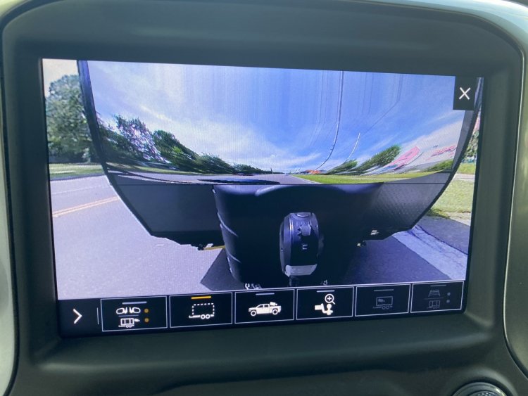

  8. Update. My setup now calibrates quickly but view is blurry. Any ideas on which dimensions I should try to play with to see if I can get it more clear? Thx

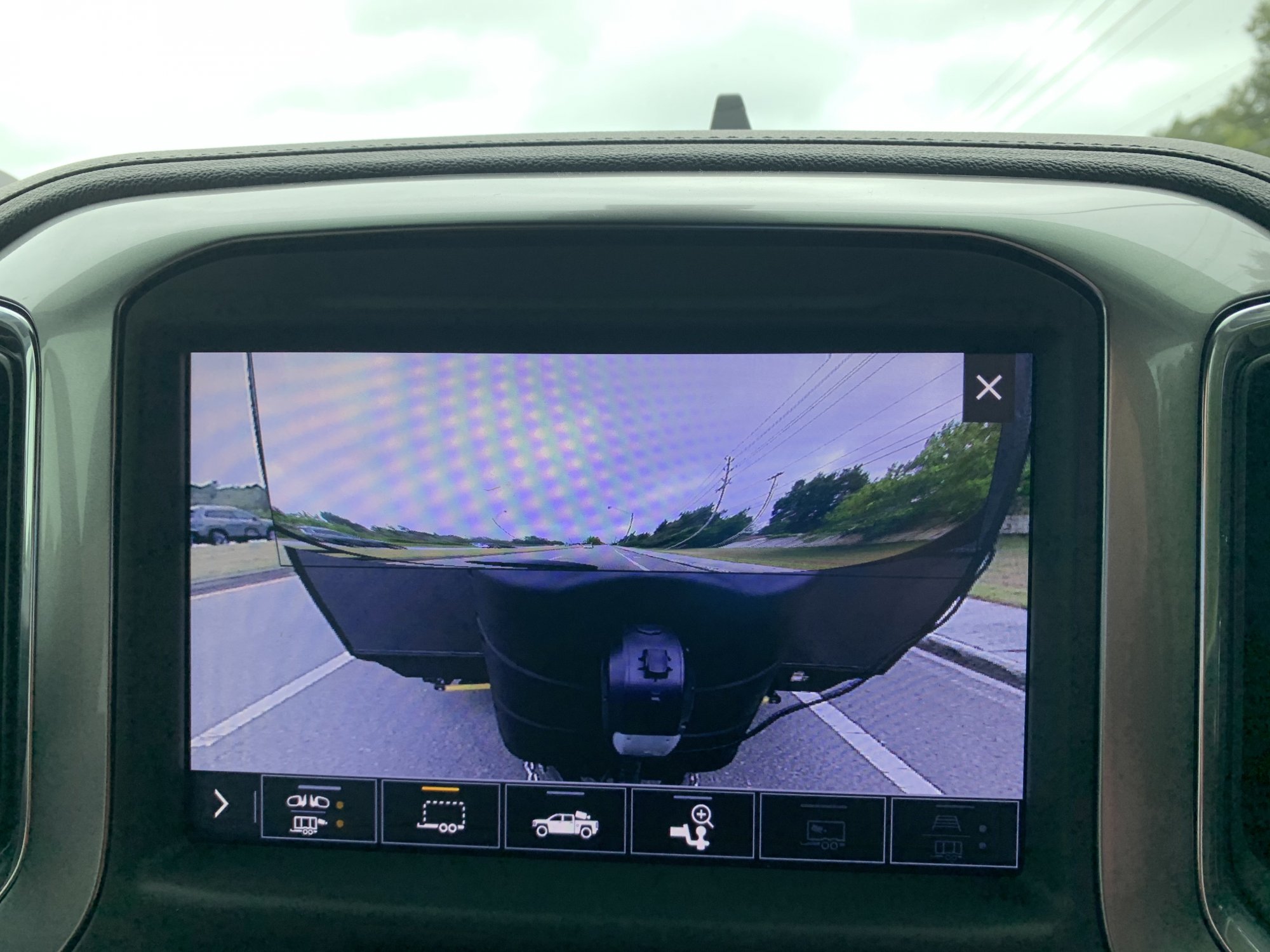

  11. Here is a pic of it when calibration times out. I am satisfied but it took long time for calibration to time out each time.
