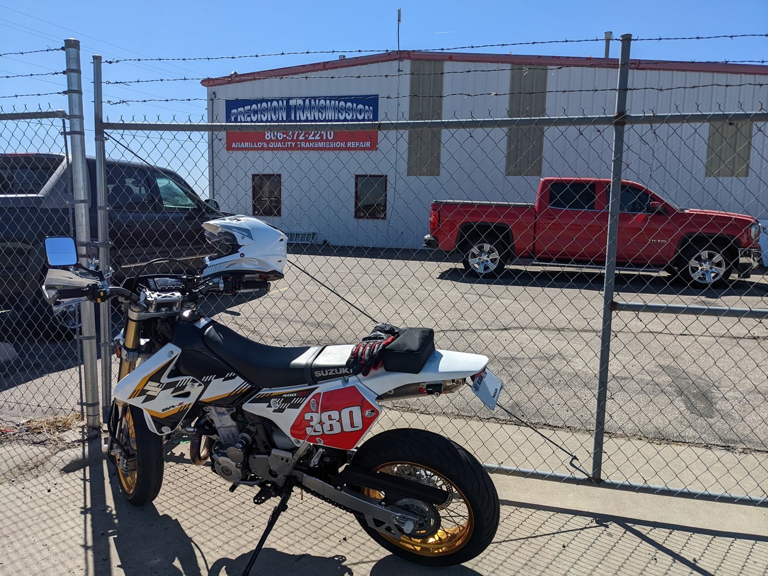

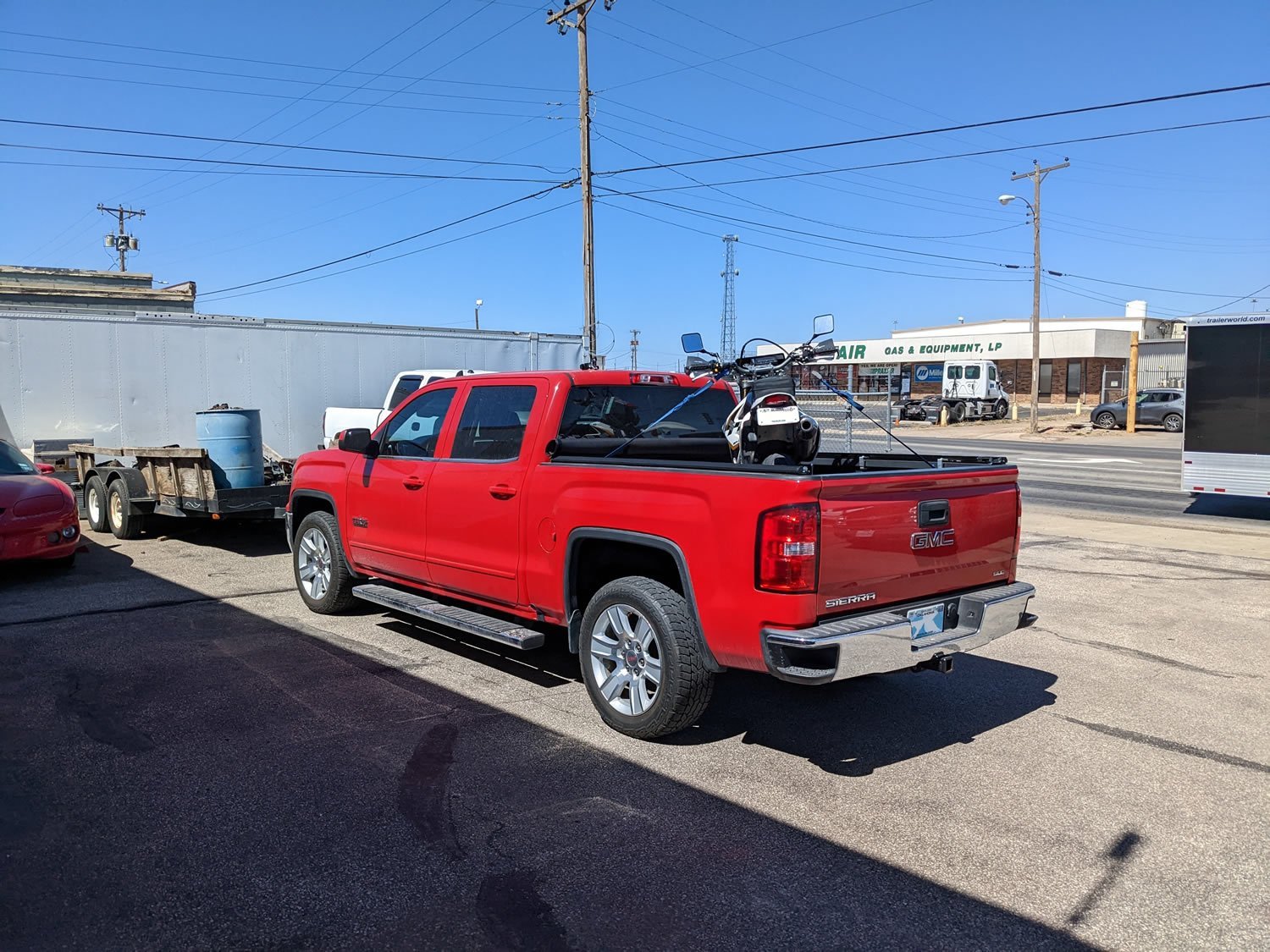

making a few additions to the thread. Shipping the truck from OKC to Amarillo was more than I expected, but there is a work-around. AAA Premier Membership! 200 mile one way free tow! So I had to cover the final 50 miles to get the truck to Precision Final bill to have it towed to their shop.... just under $250 After delivery confirmed from AAA driver, I called the shop and paid the deposit. This was to remove and inspect transmission. Was called on a Wednesday afternoon that the truck was ready. All excited, I let the woman know I would make arrangements that coming Saturday, or the next to pay and collect. Shortly after, the video of the tear down was made available on youtube. I tried calling their shop multiple times on Thursday and Friday but was never able to speak to them. no answer each time. Saturday morning!!! The alarm goes off. I decided to ride my motorcycle and brave the cold. 34 degrees at 6:20am when leaving the house. Google says 3.5 hour drive time to get to the shop. I made it just over 1 hour before my face began to freeze. With the stops for fuel, and a couple to regain feeling in my face and toes, I pulled up to the shop in Amarillo. It's now 11:48am PANIC! The shop is closed, the gates are locked, and I'm 30 ft away from my truck. Made a few calls and a post on facebook... less than 20 minutes later Richard calls me! He arrives and we end of talking for a while and he shows me the "dirty bird" and I pay the remainder, along when getting the info on a pan drop/ transmission fluid change at 3K miles. Drive the truck back home, and pull into the driveway just after 6pm. Long day and took a bit to warm up, but have driven the truck some and happy that it feels like it should. Big thanks to Precision for taking on the problem. Hope to have at least another 100k miles without problem! -

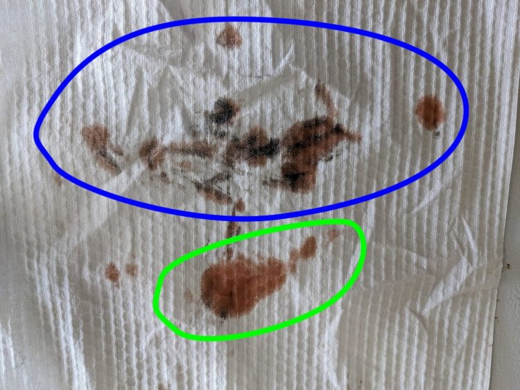

Warmed up enough for me to check the dipstick and make a quick video popped the hood and checked the transmission fluid first. results are the attached image. after checking, started the truck but didnt have my phone to record video. sounded bad for the first 1.5 seconds when i first started the truck. When shifting from P or N to R or D it sounds similar to the stress of a power steering pump at max turn for the first second. *happens later in the video when i shift a few times* https://photos.app.goo.gl/4pAFEWfw2VTajshH6 The attached image if the dipstick from the transmission BLUE = first pulling the dipstick after truck was left for almost 1 week. This was after the 100+ mile drive GREEN = Second pull of the dip stick No noticeable metallic, even when looking at the dipstick after pulling. I'm guessing the Precision transmission you mentioned above is the one from Amarillo, Tx. Tried calling a few times today, Saturday morning, but havent been able to get them on the phone. Would be a bit of a trip from Oklahoma City. So here are my concerns. - If I have a local GM dealer or transmission shop swap it out for a replacement transmission, I'm looking at 100,000 hopeful carefree miles. most are 3 year warranty on a replacement transmission. *some 6 year warranty - If I swap it out, going to have to have several uninterrupted hours to do the work. *i'm more likely to win the lotto - have a local shop rebuild, and loads of risk, as likely no warranty. My use and intentions with the truck include - sit most of the time. i have my commuter fart - around 10,000 miles per year *used for weekend trips / hauling things - dependable - responds and drives like OEM. dont want a stall that is some high RPM. Local GM dealer has trucks with the same transmission issue waiting for replacement. service writer has stated +80% that install a new torque converter and flush the system, after having an issue, are back soon with more problems. Recommends to replace transmission. starting to question replacing the parts and hope that no other issues arise. -

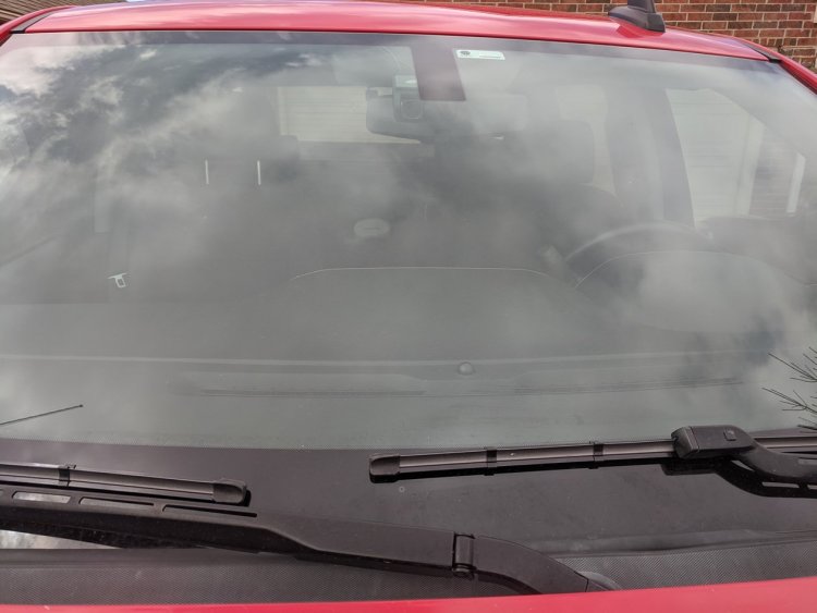

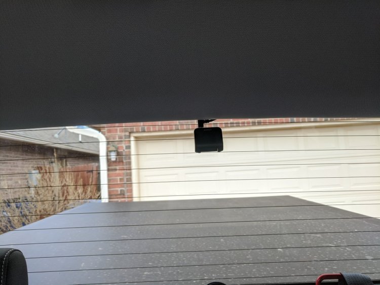

To start, there are more dash camera options available today then there are automotive manufactures. everyone has their own flavor and key requirements for what they need. I've had a couple people ask questions about what setup I'm using, how dependable it is in Oklahoma heat, what the cost totals, and what the maintenance totals. I have the same camera in each of my vehicles. The following list will help for some. AUKEY dash camera front and rear... and use the same model in all my cars. link to it on amazon $130 https://www.amazon.com/gp/product/B075S7W6FR/ref=ox_sc_saved_title_9?smid=A1GB2I3NQT9NQC&psc=1 I have the cable under the headliner and down the A pillar on the passengers side, before feeding the cable behind the bottom edge of the dash and routing the cable to the glovebox USB. I would recommend getting a 90 degree connector, as the cable that comes with the camera will get a little "kinked" when closing the glove box otherwise. link to the 90 deg cable connection $7 https://www.amazon.com/gp/product/B084WPG7QG/ref=ppx_yo_dt_b_asin_image_o00_s00?ie=UTF8&psc=1 Front camera WILL need a filter. The viofo clips onto the AUKEY perfectly! link to the filter on amazon $15 https://www.amazon.com/gp/product/B01N0KVD4C/ref=ppx_yo_dt_b_asin_title_o02_s00?ie=UTF8&psc=1 Standard memory cards will last one summer parked outside. "High Endurance" cards will get a couple of years. link to the card on amazon $22 https://www.amazon.com/SanDisk-Endurance-microSDXC-Adapter-Monitoring/dp/B07NY23WBG/ref=pd_bxgy_img_2/140-3681450-1512527?_encoding=UTF8&pd_rd_i=B07NY23WBG&pd_rd_r=93c2560a-c581-4313-9e83-56afe89b7352&pd_rd_w=u067F&pd_rd_wg=1uIsf&pf_rd_p=f325d01c-4658-4593-be83-3e12ca663f0e&pf_rd_r=NX8GAGXT7P71EWQHXYJR&psc=1&refRID=NX8GAGXT7P71EWQHXYJR TOTAL $175 *add in some tax and it's close to 200 The attached images show the cameras, front and rear, installed in my sierra. Out of sight, out of mind! The camera will make a chirp and whoosh sound when it boots. Link to videos from the camera. Front camera Rear camera in the last 3 years these cameras have saved 10 times what ive paid for them in different events that have happened. *"they rear ended me officer!" and then i share the footage that shows they backed into me* good investment
Dash Cameras
pixelmonkey380 replied to kodiakdenali's topic in 2019-2026 Silverado 1500 & Sierra 1500
using a AUKEY in mine... and use the same model in all my cars. link to it on amazon https://www.amazon.com/gp/product/B075S7W6FR/ref=ox_sc_saved_title_9?smid=A1GB2I3NQT9NQC&psc=1 I have the cable under the headliner and down the A pillar on the passengers side, before feeding the cable behind the bottom edge of the dash and routing the cable to the glovebox USB. I would recommend getting a 90 degree connector, as the cable that comes with the camera will get a little "kinked" when closing the glove box otherwise. link to the 90 deg cable connection https://www.amazon.com/gp/product/B084WPG7QG/ref=ppx_yo_dt_b_asin_image_o00_s00?ie=UTF8&psc=1 Front camera WILL need a filter. The viofo clips onto the AUKEY perfectly! link to the filter on amazon https://www.amazon.com/gp/product/B01N0KVD4C/ref=ppx_yo_dt_b_asin_title_o02_s00?ie=UTF8&psc=1 Standard memory cards will last one summer parked outside. "High Endurance" cards will get a couple of years. link to the card on amazon https://www.amazon.com/SanDisk-Endurance-microSDXC-Adapter-Monitoring/dp/B07NY23WBG/ref=pd_bxgy_img_2/140-3681450-1512527?_encoding=UTF8&pd_rd_i=B07NY23WBG&pd_rd_r=93c2560a-c581-4313-9e83-56afe89b7352&pd_rd_w=u067F&pd_rd_wg=1uIsf&pf_rd_p=f325d01c-4658-4593-be83-3e12ca663f0e&pf_rd_r=NX8GAGXT7P71EWQHXYJR&psc=1&refRID=NX8GAGXT7P71EWQHXYJR in the last 3 years these cameras have saved 10 times what ive paid for them in different events that have happened. *"they rear ended me officer!" and then i share the footage that shows they backed into me* good investment *NOTE: if anyone is interested, I can snap a few photos and video tomorrow to share* Thread with photos and video from the camera installed. <--- Click -
