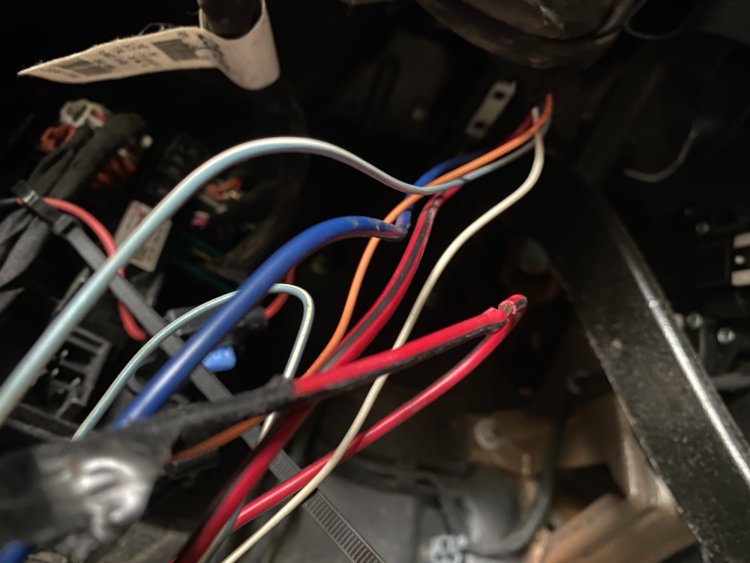

  1. So as my previous threads have stated, I bought the truck from a dealership who’s basically after I threatened to get my lawyer involved they said they couldn’t have any further communications with me all because they refused to fix the mistakes they made. I go in today to look into the wiring under the dash and noticed a red wire, and a blue one going under the carpet, well got to looking and it’s running to the fuel pump. I found a receipt where they replaced the fuel pump and instead of wiring it the right way they spliced into what looks like the plug in for one of the air bag plug ins. They skinned the wire back and soldered it onto a known key on/hot. Well then I seen these wires dangling from a loom right under the dash, it’s a factory loom and even had the wires labeled under the dash but didn’t say to what. So what are these wires for? I used the multimeter and didn’t get any power from them, so not sure what they would go to. All I know is I’m more than pissed at the poor workmanship these people did. I’m taking it to the dealer soon to get the speedometer fixed because it’s +/- 10 over, and the service air bag light is on, but it also has the recall on the air bag. So what gives, what are these wires to, and where would the fuel pump hot wire originate from anyways. I think what happened is one of the block grounds broke off, the main one on the back of the block and that’s why they hooked it up to the hot the water they did, why I say this is because I found the hood to body ground laying in the engine compartment. Anyways, y’all got ideas on these wires, and where the hot for the fuel pump would actually go so that I can fix their mess?

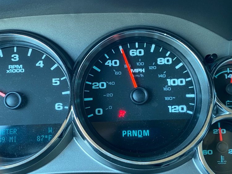

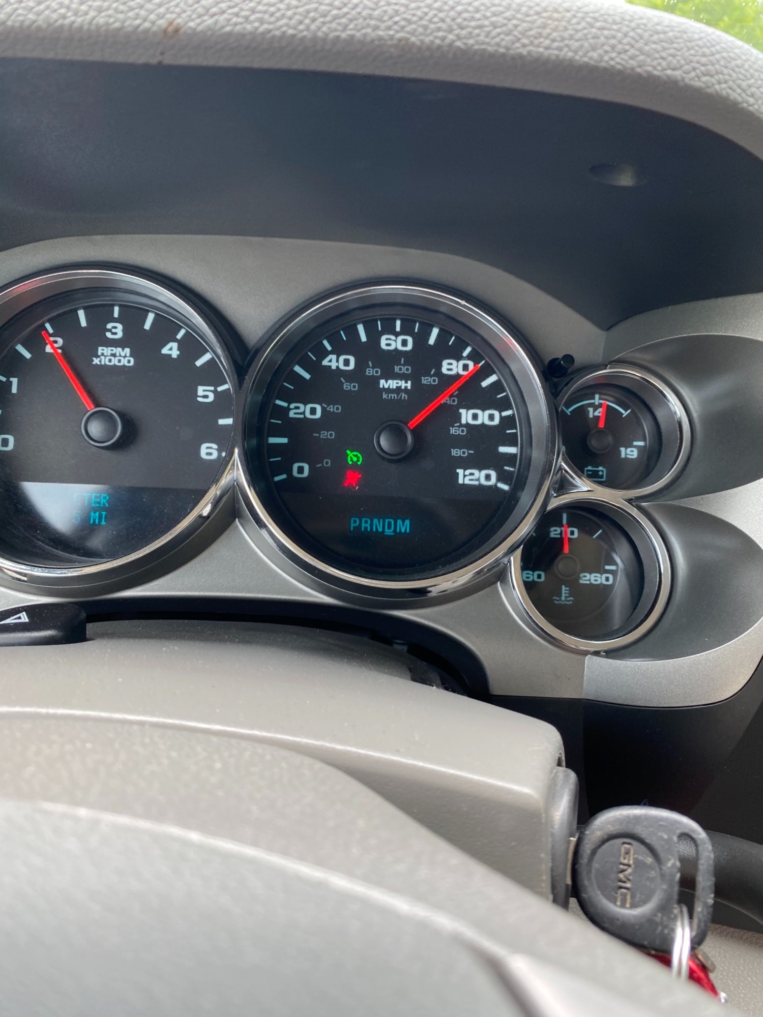

  2. Here’s what puzzling to me, when the truck is in gear, with the foot on the brake the needle is above zero. My Denali you can put it in gear and it won’t move anywhere above zero unless you’re going 2-3 mph, and is steady all the way. This one here shoots us like a rocket on the interstate. Here’s a pic of it on the interstate today (this is after I put in a VSS in the trans), and going 75. It’s showing 85 on speedo so it’s + or - 10 off depending on road conditions, and the needle goes above zero before you even move. When it’s in park it’s well below zero.

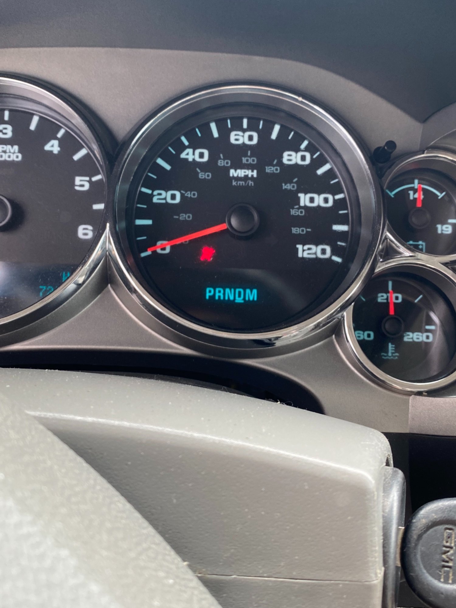

  3. This is how annoying it is. I went ahead out of my better judgement and put a VSS in the tail shaft on the trans, and also a passenger airbag sensor, I am having to reschedule my appt for the dealer. I’ve got a sick 3 year old, but I did notice when the truck is in gear and foot on brake the needle is above the 0 mark, not normal cause my last one heck you put it in gear and it stayed below zero as if it was set to give it a mile or two slower before the needle would move. It was so accurate that I had it set like clockwork everyday for all the speed traps. I’m sending a few pics. One is at rest with foot on brake with it in gear, the other one is on the interstate with cruise set at 75 and it shows 85. I got my multimeter and ohmmeter earlier to work on some other stuff. I noticed even though my truck came with the RPO package for electric start they put a aftermarket antenna inside the vehicle but of course didn’t have that key.

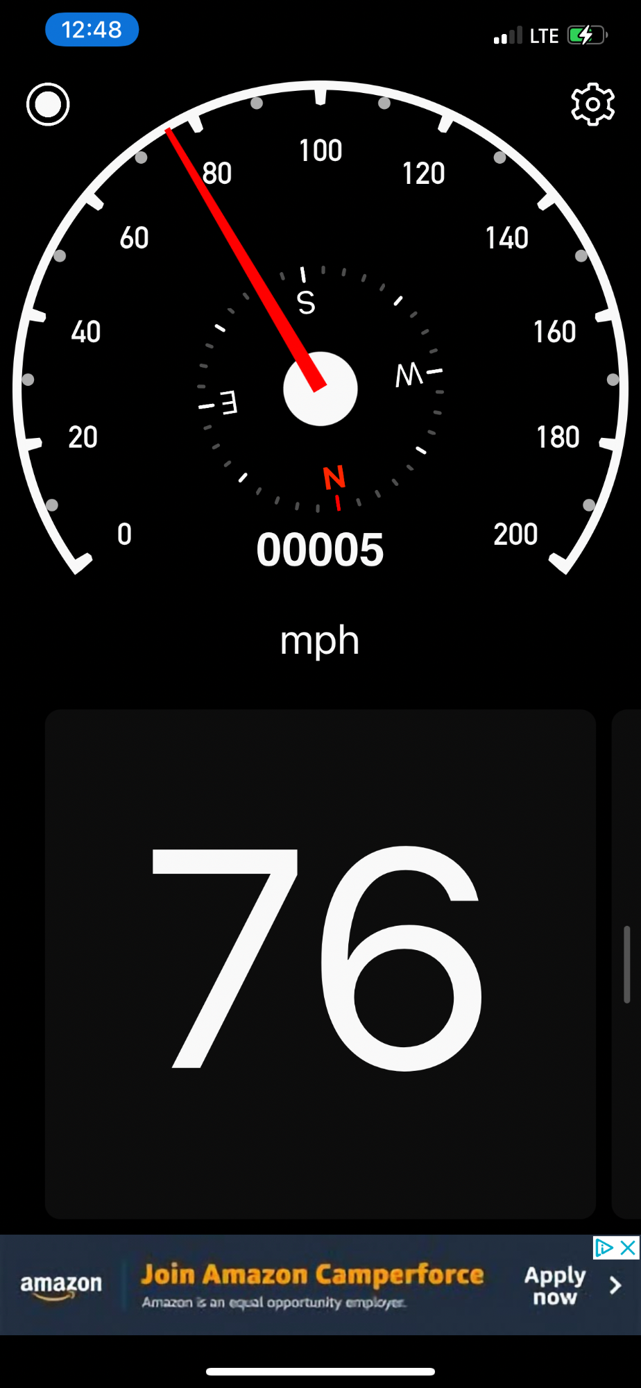

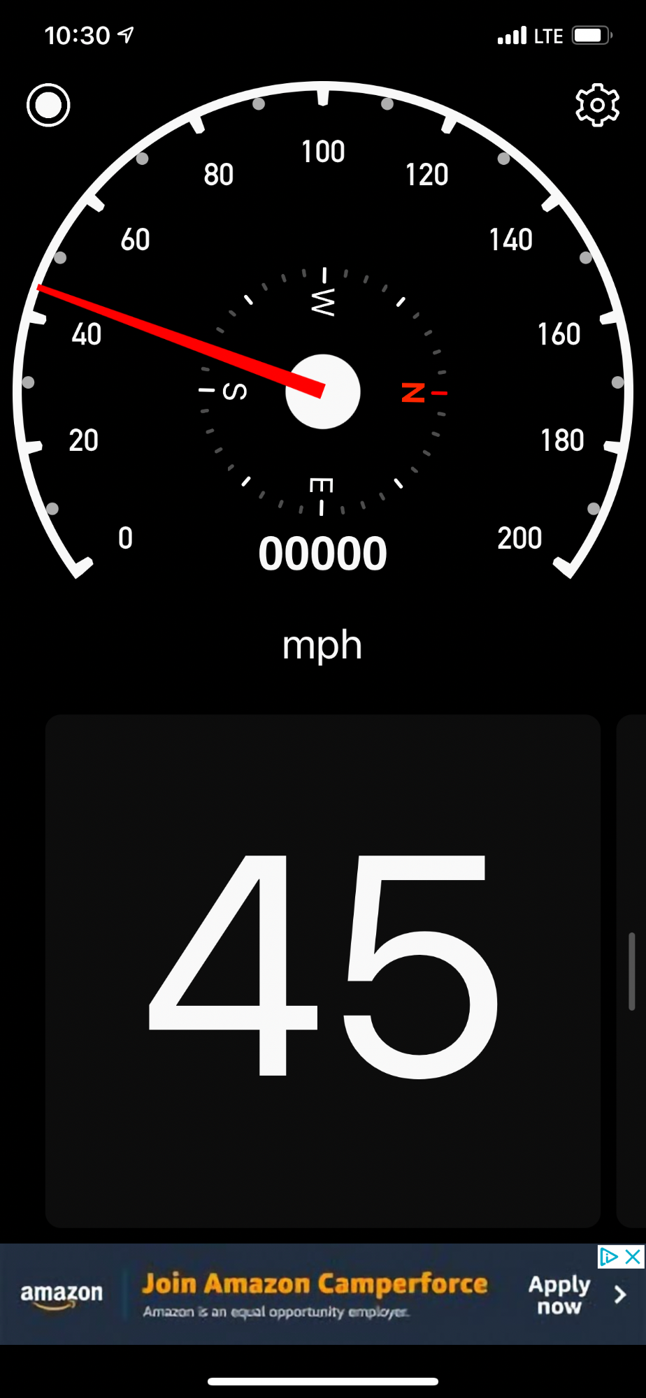

  8. So I bought the truck. Didn’t notice the speed was off by 10 until I got onto the interstate, and people passing me. I checked tire sizes, all factory sizes, hooked up my scanner and oddly enough the speed on OBD2 scanner read the same as the speedo. So after checking and verifying tire size was correct, and checking seeing that it was being sent via OBD false as well I am stumped. At 60 I’m going 48-50+/-, and at 85 it’s really going 75 +/-. What’s your observations? It’s on a 2011 GMC Sierra Cree Cab 4wd, all auto. In the photos I was going what was supposed to be 40 and it shows 50 on speedo, and on GPS it shows 45. So it’s + or - 5-10 at low speeds and at 75 it will show 85. What do y’all think. I’m retired ASE Master engine tech and can work on these but I was in the diesel industry. So while working on vehicles are nothing new. This speed has me stumped. I don’t want to take it to dealer if it’s the VSS on the rear of tail housing near transfer case, and I’ve also heard of a VSS Buffer? Someone elaborate a little on whether it could be related to that. There’s a ABS light flashing on OBD scanner but no active codes.
