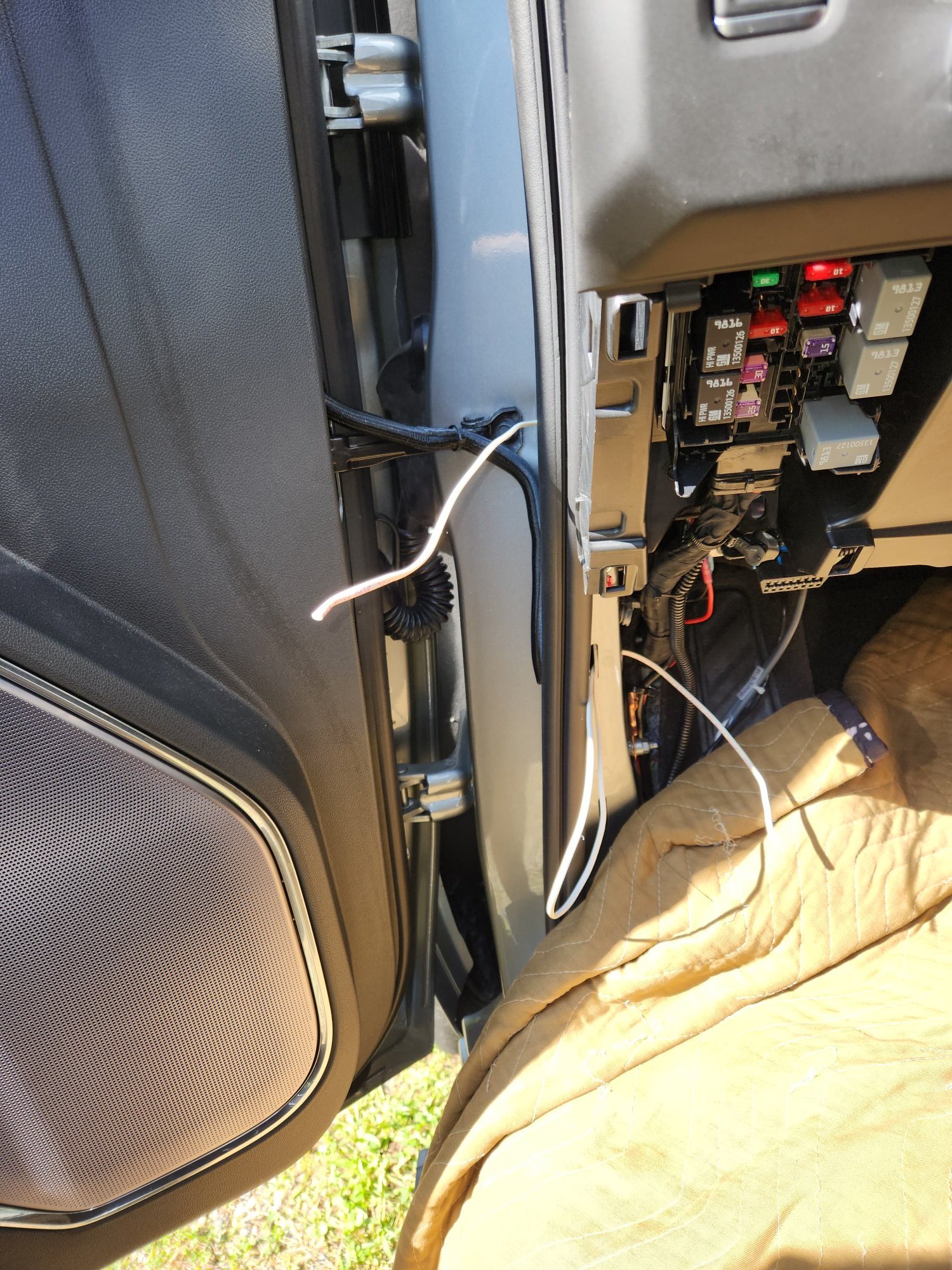

Forgot to mention......The pic of the Left Fuse Panel, shows my white stiff "fish" wire in the "A" Pillar, able to get into the kick panel, and routed 12 vdc., into the door, for a LED under the door card pocket bottom. To light up the running boards. Did a "Star cut with an "X-Axto Knife",", in the rubber grommet, to feed the braid wire conduit thru it into "A" Pillar. One mini Zip Ty thru door check arm hole, seems to hold the conduit OK. Goes into the door shell, on the lower outside of the check arm, was able to snake thru.

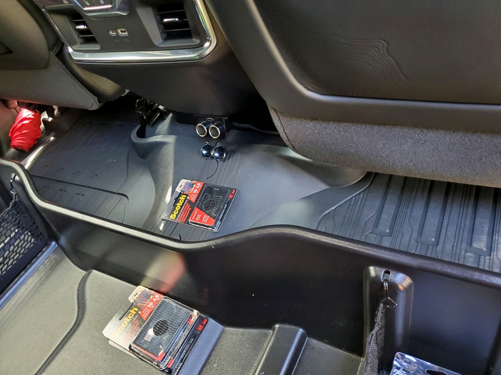

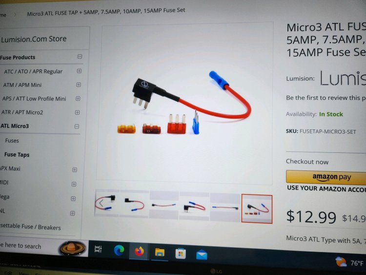

My new '24 HD, sadly has no cigar 12 vdc. outlets. The USB's available I found were Slow Charging. Not to mention the terrible interior lack of lighting. Thanks to 64BAwagon and Don's Life posts & solutions on that Cabin Lighting. Credit to Don's Life on the Micro-3 Fuse Tap Pic. Here is what I did for adding power outlets. Found there IS a Fuse Panel on Driver's side dash, not so populated, as the right dash one. Guy's, the GM schematics are PDF down-loadable on the GM Upfitters site. Dual inside the arm rest, ( can still use phone charger), and dual on lower rear of this center console by rear floor (under HVAC vents). Will add 2 more pix next, at max file size here.

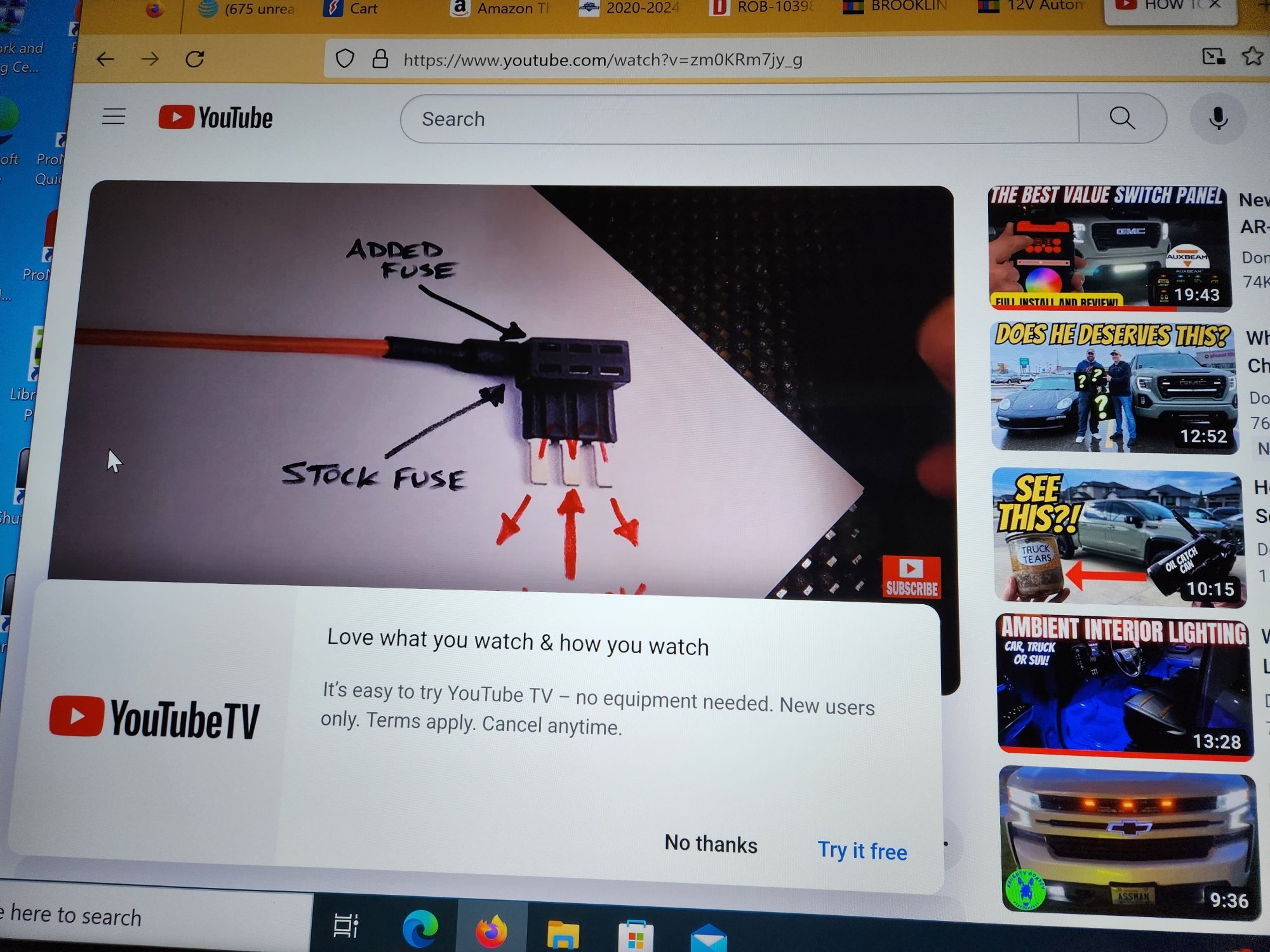

Got to max file size on last pix. Don's Life You Tube on Interior Lighting, showed his discovery, on how a Micro3 Blade fuse and Tap works. He has so many GM Truck excellent video posts on improvement to these trucks. One most important one, is the Factory Upfitter Switch Kit, (9L7), still not available for the '24 AT4x and Denali. This to neatly add more powered owner options, like lighting, air compressor, Plow Lights, etc. Research we all have done, installing this factory 9L7 kit, and connecting accessories is a real xxxx-xx-******-****** !! All wiring must penetrate the firewall. Don's Life reviewed the Aux-Panel Kit. Locates in the engine bay. Everything connects there. My next to add. See you are in VT. I just Woolwax Rust-Proofed my '24. Removed the wheel well liners first. Got the rocker panels and door cavities as well. Other inert non-chemical Lanolin wax rustproof products out there as well. Did my '16 HD with Ziebart. Never again. Process does not weep into seams. Screen pic attached, on right are a few of Don's other You Tube how to videos. -

You may find it easier and neater , to put the Lighter Outlet(s), under the center arm rest, in back of the phone charger pad. I also put a dual outlet on the face of this console rear, for charging tools , etc. on my '24 HD. Saw a post before, the the '24's only have fuse panel on the right dash. NOT true. Wish I looked further. Here is a easy access, less populated one with spare spots in driver's left knee bolster. Dash right side fuse panel is a populated mess. Also Cabin lighting SUCKS. See many posts by 64BAwagon, myself and Don's Life You Tube, for solutions. 64BAwagon did a great documentation, using a part(wire & connector pin) of the door sill plate Illumination kit, to tap into the X1 BCM plug, above driver's left foot next to firewall. Before I saw his post, I did it the extreme hard way, Designed my own relay logic, tapped off the dome lamp feed, with protection,so not to damage the BCM Computer circuit. GM really blew it on these missing features, as much as I love this new '24 Denali HD otherwise. -

Door existing rubber wire boot I was able to pull out each end out of the sheetmetal, to explore possible snaking of power wires for adding a LED to the door bottom trim. Door end is a straight shot in with the wire harness with no obstructions. "A" Pillar side more complex and tight, but possible. Long vertical fixed connector, but some space above it to feed wire thru. Need to get my Milwaukee LCD cavity camera to poke in there tomorrow when the rain stops, to see if it goes thru the 2 or 3 layers of sheetmetal, to exit into where the BCM module resides. ( where the X-1 connector is for adding the LED Sill Plate kit). Let Ya'll know. FYI: Did find some great wiring web sites , "keepitcleanwiring.com", has several types of door loom kits, and Ron Francis Wire Works ( has really cool Heat Shrink Tube in a Woven Material, 1/2, 3/4, 1" I.D. ) that would match up to Dorman Builder Series split woven wire loom.
Door LED wiring.....Ideas......... I do have some 1/4" o.d. split wire loom left, would be an option, although not my best choice. Quick search on Sumitt and Jeg's, found some very nice specific door jamb wire loom kits, like for adding power windows, locks, speaker etc. One is GM A body door jamb specific, may be too short. These will require a right angle drill or Dremel type adaptor, to put a hole in the door by the check arm. Search of some Street Rod site would have kit like these as well. Want to keep it OEM looking best as possible. I'm not a hacker. KP.

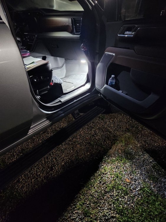

Matt / All: Able to re-size this pic down to 1.3mb. My KC Cyclone puck "Rock Lights". do clear the sill plate mounted to the door bottom trim, if screwed thru it's center hole into the door card plastic, under the front cup holder pocket. It will hit if Velcro is used, as I found with this first test, just to hold in place, and get this pic. I plan to route the two wire #18ga. with a split rib 1/4" wire loom conduit, up past the speakers, thru the door check arm opening, and into the lower A Pillar rubber grommet plug. Using the RGB LED's you have, should have no issue driving them off the Sill Plate LED X-1 Pin-1 circuit. With LED's like the KC's I have, must use that X-1 circuit, with a 300mfd. Cap, diode and 220 OHM resistor, to drive a mini Amphenol 5vdc relay for a strong 12 vdc. & added 5 amp piggyback fuse off the fuse box. Will not get the full Light theater fade on/off of the Dome/Map lights, but at least it is controlled by the doors automatically. I "T" Tapped into the Dome/map White/Green wire, in the front roof pod, which is the same Interior Lamp Control like the X-1_Pin-1. This in the White connector to the right of the Grey Sunroof plug, and far right black plug. What an ordeal of R&D.

Matt, yes a real PIA to do what should have been a standard lighting feature. I just tested adding another KC Cyclone LED under the door panel bottom pocket. Lights up the running board and ground below very well. Wires will have to go from door check arm opening, to the A pillar lower rubber hole plug, thru a Dorman type 1/4" plastic flex rib wire conduit.. Found a You Tube video on how to pull the door panel card off safely. File size of this pic may not make the cut. My choice of the Kc's, found they need at least 7.5 vdc. to light up, although dim. On 12 v. they rock ! So I needed to design the relay to power the coil off the Dome / Map PWM circuit. Added a Little Fuse piggyback tap in the passenger fuse box, for the solid 12v. Using the strip LED's like you did, work great off the existing 5.6 vdc. PWM interior circuit. Much less complicated, than what I got myself into with the KC's. Booo, would not me load the pic with both LED's, was 5.1 mb., so this will have to do. Take my word, the door under panel LED under the bottle holder area, is the cherry on top of this project. This under dash LED gets some ground lit, but not the running boards at all.

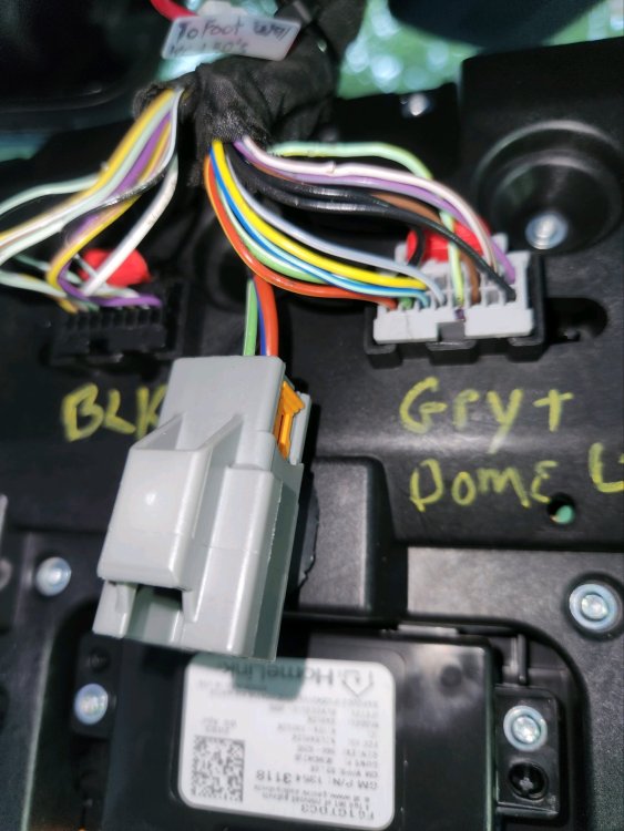

Matt ; Is that X-1 Pin-1 circuit 12 vdc. ? Another post from SC in Michigan, said he did run LED's off X-1- Pin-1 without a relay. I tapped into the Dome /Map feed wire , and it is a Transistor controlled PWM (pulse Width Modulated) circuit. Off that one, I measured 5.6 vdc to chassis gnd. Driving a 5 vdc relay, the coil buzzed from the "chopped" DC voltage. Added a 300 mfd. tantalum capacititor to smooth out the ripple / buzz, and 5 watt diode to prevent damage to the BCM circuit. I'm using 4 ea. KC Cyclone LED pucks, they draw .4 amps each. Another post to you on page 3 said also on X-1 pin 23 , circuit 157 , for Interior Lamp Control also works to tap into. GM should be ashamed, never mind the end , high $$ trucks should have interior liting like this , but the Pro and WT as well, should be standard. I went through a lot of Time, Sweat, Posts and George Carlin words to sort this out.
